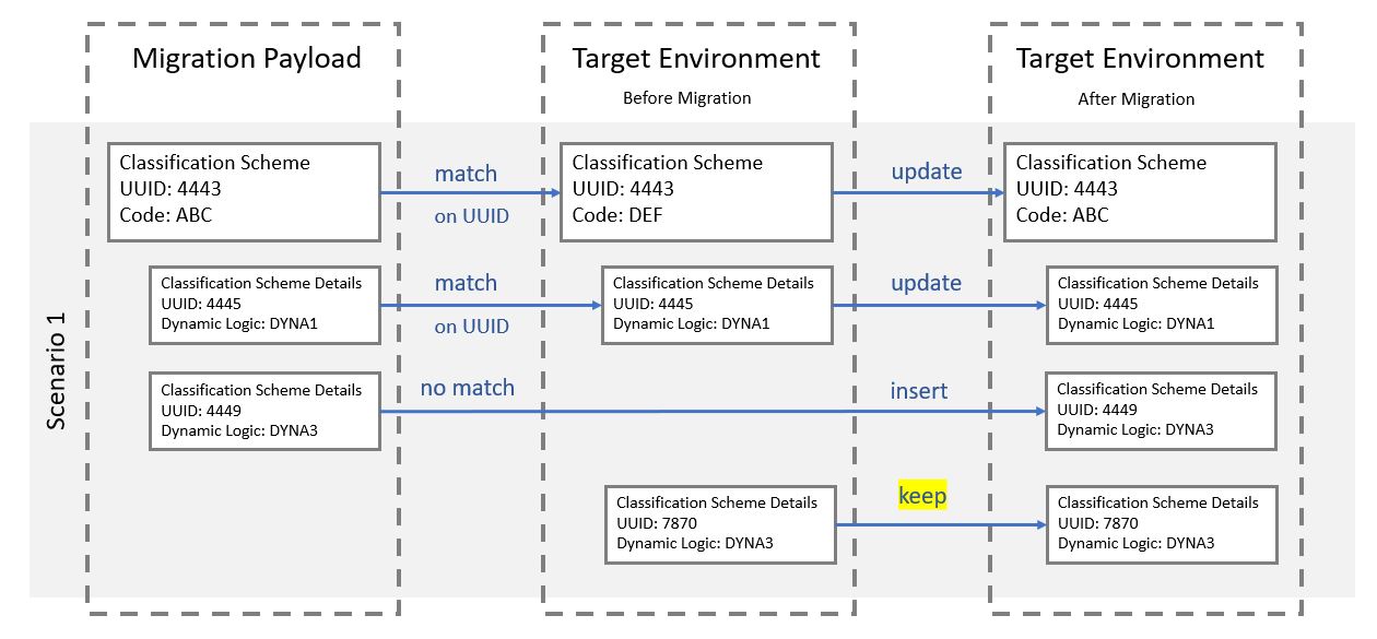

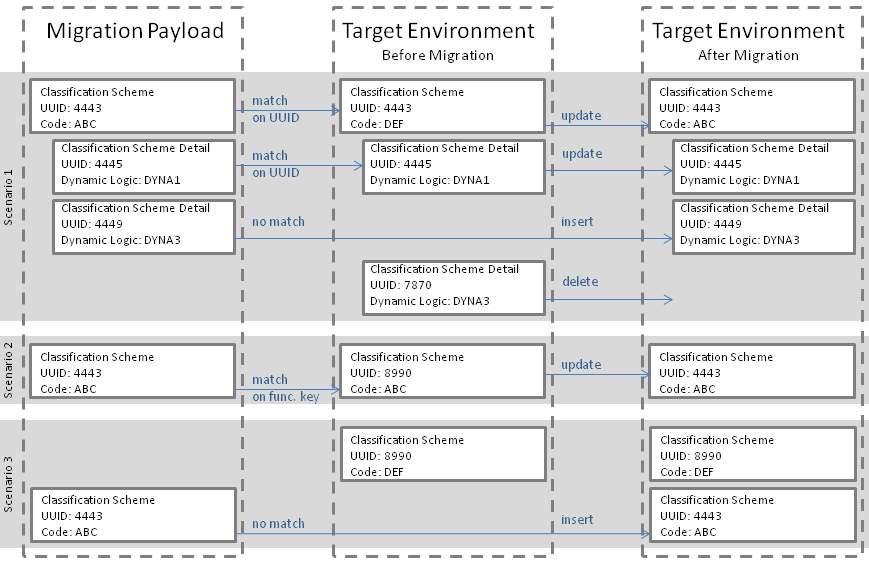

Migration Behavior
The migration function creates, updates and deletes configuration. To do this, the function needs to recognize the same configuration item across environments. Finding the existing counterpart of an configuration item in the migration payload is called matching.
Matching top level items is a two-pass process. The first pass attempts to match the universally unique identifier (UUID) of the item in the migration set to an existing item on the target environment. The UUID is a system generated key, that is assigned to each configuration item upon creation, unless created through a migration. If the item is created through a migration the UUID of the item in the migration payload is adopted. This ensures that the UUID for the same configuration item is the same across all environments, as long as the migration function is the only means of creating new configuration items on target environments. If the function succeeds in finding an existing configuration item with the same UUID, then that item is updated.
If the UUID match fails, the second pass attempts to match on a functional key, that is, a user defined key. For most configuration items the "Code" field is the functional key. This means that if the item in the migration payload has the same code as an item in the target environment then it is considered a match. Some configuration items have a more elaborate functional key, because they do not have a code, for example, a provider pricing clause. For these items the secondary match is based on a combination of functional attributes.
Migration Behavior
The reason for the two-pass approach is that neither UUID matching, nor functional key matching is foolproof; matching exclusively on UUID fails if the same configuration already exists on the target environment (inserted by means other than migration), matching exclusively on the functional key fails when (part of) the key is updated on either environment. The two-pass approach counters these drawbacks - it gives robustness against updates of key fields and the ability to identify the same configuration items across environments.
Some of the functional keys comprise language dependent fields. The functional keys in the migration set are the keys in context of the default language on the source environment. Upon import, language dependent functional keys are interpreted in context of the default language of the target environment.
If neither the UUID nor the functional key matches, the migration import function inserts the configuration item on the target environment. If matched successfully, then all functional attributes of the existing item are updated with the value provided in the migration payload. Any existing detail matched with a detail in the migration set is updated. Details in the migration payload that do not exist on the target environment are inserted.
If the migration set does not specify an inclusion date, then any existing detail that is not matched, is deleted.
Because most details are matched on UUID alone, updates to those details that have not been created by a prior migration follow a replacement pattern (that is as opposed to an 'update' pattern). This is illustrated in scenario 1; the classification scheme detail referring to DYNA3 has been keyed in on both the source and target environment.
If an item (top level or detail) is matched on functional key then the existing item adopts the UUID in the migration payload.

Instead of physically deleting these configuration records, the migration function 'disables' them. This exception applies to fee schedule lines and product benefit specifications.

Delete by Omission
The following configuration items depend on top level items - they cannot exist by themselves. The configuration import function treats these just like other attributes on the top level item; if not present in the payload, that means these items have been removed on the source environment and therefore can be deleted in the target environment as well.
Note that the 'High Volume' configuration items (see Building a Migration Set) are not deleted on the target environment if the configuration set specifies an inclusion date. The reason is that the target environment is not able to distinguish between records that are omitted from the set because they are deleted or because they have not been updated since the inclusion date.

Switching off Delete by Omission
The ‘delete by omission’ behavior is enabled by default. The user can override this behavior either when creating a new migration set in the source environment or when importing a migration set in the target environment. This behavior applies across all entities in the migration set; either all dependent items are deleted by omission or none of them are.
If the user overrides the behavior upon generation of the migration set, then the payload is marked so that the target system knows not to delete by omission. If the user specifies the desired delete behavior upon importing a migration set, then the import ignores the whatever instructions are included in the payload.
migration behavior
To clarify this feature, consider the image above. The default system behavior removes item 7870 but if the user disables the ‘delete by omission’ feature then item 7870 remains unaffected.
