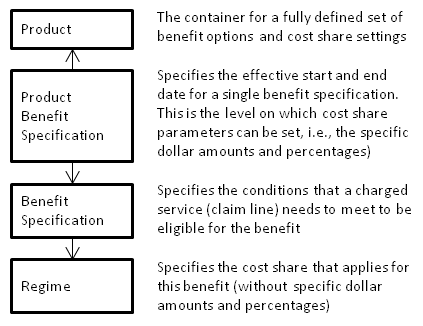

Benefit plans come in many variations, where part of the plan is common across plans, and part is specific to the account for which the plan is designed. In Claims a benefit plan for which all options have been defined is called a product. In other words, a product is the complete package of configuration needed to adjudicate claims,including all benefit options and cost-share settings.
The Claims data model can be characterized as fairly flat; it is a four level structure where the top level is the product, and the bottom level is the coverage regime.

Product Benefit Specifications
A benefit specification can be linked to one or more products in a time valid way through product benefit specifications. A product benefit specification has the following fields:
