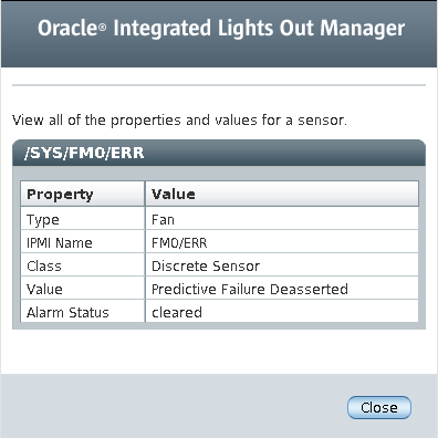

To view sensor readings, you need the Read Only (o) role enabled.
The Oracle Integrated Lights Out Manager Login screen is displayed.
When you first try to access the ILOM service processor, you are prompted to type the default user name and password:
Default user name: root
Default password: changeme
The sensor readings are displayed.
Note - If the server is powered off, many components will have no readings.
For specific details about the type of discrete sensor targets you can access, as well as the paths to access them, refer to the Oracle Integrated Lights Out Manager (ILOM) 3.0 Supplement for the Sun Fire X4800 Server.
