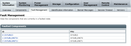

    • Select the Fault Management tab.
      image:Figure showing Fault Management tab.

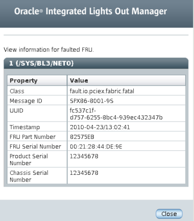

      The Fault Management page lists faulted components by ID, FRU, and time stamp. You can access additional information about the faulted component by clicking the faulted component ID.

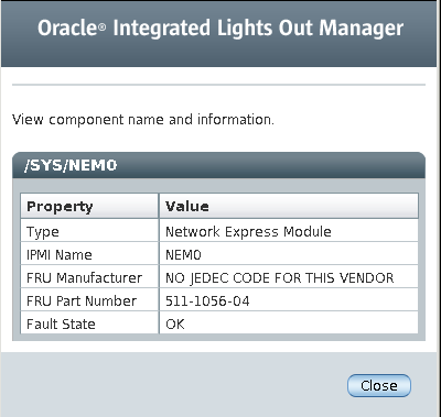

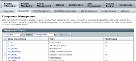

    • Identify the fault status of a component on the Component Management page.
      image:Figure showing Component Management page
      Click on the component name for the item that has Faulted status. Additional information about the faulted component is displayed.
      image:Figure showing component detail.
