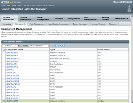

  1. Log in to the ILOM web interface.
  2. Select the Components sub-tab under System Information.
  3. Locate the component that is in the Faulted state and select the radio button to the left of the component name.
    image:Select Component in Component Management page

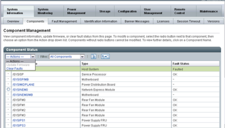

  4. Select Clear Faults from the Actions drop-down menu.
    image:Select Clear Faults from the Actions drop-down menu
