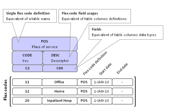

Flex Code Definitions
Consider the following image. It shows the configuration breakdown of a flex code definition and its flex codes. Flex codes are values that represent a domain. The purpose of such a domain is to bound the values of a dynamic field. A flex code is not (necessarily) a single value, that is, commonly a flex code is a record of several fields, each field with its own value. For example, a flex code can consist of a code and description field, as shown in the figure below. In this sense, a flex code definition is very similar to a table definition. The columns of the table are defined by flex code field usages. A flex code always keeps track of a start and end date, and the definition to which it belongs.
Flex Code Definition Overview
Note that the image reflects the setup for a flex code system that is used to specify a dynamic field. On the other hand, flex code systems that are used to specify procedure, diagnosis and provider codes do not have flex codes as values. Instead, these flex code systems are populated by the actual records in the procedure, diagnosis and provider tables.

To clarify the purpose of the listed attributes consider the following scenario:
A payer wants to extend claim lines on professional claims with a field that captures the 'place of service' attribute. The payer intends to use a flex code system for this dynamic field. The payer sets up the following flex code definition:
  • Code: POS
  • Description: Place of service on professional claims
For each possible place of service, the payer stores two fields: the key, which is a two digit code, and a description, which is a 60 character field. For this purpose, the payer creates two flex fields:
  • Code: D2, Data type: char, Length: 2, condition: ONLY DIGITS
  • Code: C60, Data type: char, Length: 60
The condition ONLY DIGITS is a condition dynamic logic that enforces that only characters 0 through 9 are allowed. The reason why this field is specified as a character field rather than a number field is that only character fields are allowed to be used as flex code key fields. The last step is to specify the flex code fields, connecting the flex code definition with the flex fields. The payer creates the following two flex code field usages for the POS flex code definition:
  • Code: "pos", Display name: "PoS", Display sequence:0, Flex field:D2, Key?: checked, Mandatory?: checked.
  • Code: "description", Display name: "Description", Display sequence:1, Flex field:C60, Description?: checked, Mandatory?: checked.
The payer has now set up a complete definition. The next step is to setup the allowed values within this definition, that is, the flex codes. The following rules apply to flex code field usages within the context one flex code definition:

  • Field 'NDC', code 'CODE', display name 'Code' . Key field. Because key is checked this field defaults to mandatory and the display sequence defaults to 0.
  • Field 'C60', code 'DESC', display name 'Description'. Descriptor field. The display sequence is set to 1.
The result is a flex code definition that consists of two fields. In order to make this definition available for procedures, the payer is required to add the definition to the flex code set that designated as the flex code set for procedure codes. This set is marked by a technical flag that is not configurable through the Claims user interface pages. The 'procedure' flex code set is set up and marked as part of the implementation of Claims.
National Drug Codes Example
The payer adds the NDC flex code definition to the flex code set named PROCEDURES. By doing so, the NDC definition becomes one of the available definitions for a procedure code.
The image shows the result of the setup described in this scenario. Each procedure record keeps track of the flex code definition by which it is defined, therefore imposing any validations associated with that definition on the procedure code. A procedure may belong to any one definition that is part of the 'procedure' flex code set.
