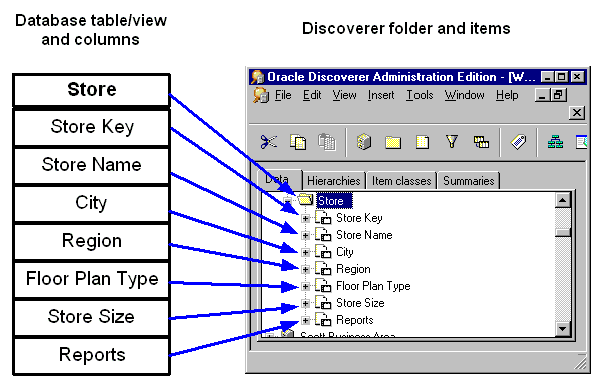

Simple folders contain items based on columns in a single database table or view. Items in a simple folder can also represent calculations on other items in the folder.
You create a simple folder by loading a table definition or table metadata from the database or a gateway.

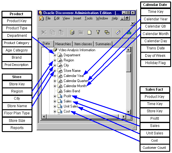

Complex folders contain items from one or more other folders. Complex folders enable you to create a combined view of data from multiple folders. This is analogous to a view in the database.
Using a complex folder enables you to simplify the business area without creating a new database view. For example, you can create a complex folder called Dept-Emp which has columns from both the DEPT and EMP tables. The user can select from one folder instead of two.
For two items from different folders to belong to the same complex folder, a join condition must exist between the two folders. For more information about joins, see Chapter 10, "What are joins?".
You could produce the same result set using a database view instead of a complex folder. However, using a complex folder instead of a database view offers several advantages. You can:

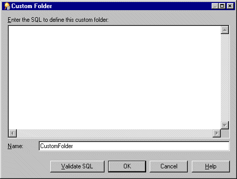

Custom folders are folders based on a SQL statement which could include SET operators such as UNION, CONNECT BY, MINUS, INTERSECT and synonyms that you type directly into a dialog.
By defining a custom folder, you can quickly create a folder that represents a complicated result set. When you save the custom folder, Discoverer Administrator creates items using the 'Select' part of the SQL statement you have entered.

To create a complex folder:
Hint: You might find it easier to drag items between folders if you have two Workareas open. To open a second Workarea, choose Window | New Window.
Each item that you add to a complex folder must belong to a folder that is joined to the folder of at least one other item that is already in the complex folder. If this is not the case, Discoverer Administrator will display an error dialog. For more information about joins, see Chapter 10, "Creating and maintaining joins".
If you include an item from a simple folder in a complex folder, the new item in the complex folder is not totally independent of the original item. For more information, see "About dependencies between folders".
To create a custom folder:
You can include comments as separate lines within the SQL statement by starting the comment line with two dash characters (i.e. - -).

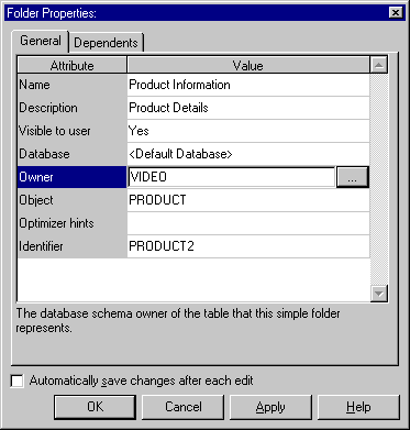

To base a simple folder on a table/view without specifying the database user name, clear the Owner field. When the Owner field is left blank, Discoverer Administrator generates SQL that does not include the owner before the table name.
For example, if the Owner field contains the name of the schema that owns the table/view, the generated SQL statement might be:
select <column> from <owner>.<table>
If you clear the Owner field, the generated SQL statement would be:
select <column> from <table>
If the object is not in the current schema, a warning is displayed.
