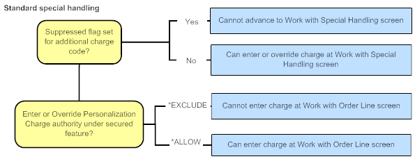

• Bypassing or Suppressing the Special Handling Screens

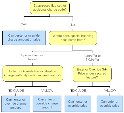

• Overriding the Special Handling Charge or Price

• Standard special handling (the S/H type (Special handling type) is S) supports entry of free-form text instructions.
• Custom special handling (the S/H type (Special handling type) is C) supports entry of specific fields, with default entries and validation. You use the Establishing Custom Special Handling Formats (WSHF) menu option for format setup.
See the Work with Special Handling Screen and the Work with Custom Special Handling Screen for more discussion of standard or custom special handling.

How much does the special handling cost? The system determines the special handling charge by:
• Special handling charge break? If there are any charge breaks set up for the additional charge code at the Work with S/H Charge Breaks Screen, use the highest charge amount for which the order qualifies, in addition to any Default price or Default price % from the custom special handing format, if any. See Using Special Handling Charge Breaks for examples; otherwise,
• Special handling price from Item or SKU Offer? If there are no charge breaks, but a S/H price (Special handling price) is specified for the Item or SKU Offer, use this price; otherwise,
• Feature option price from custom special handling format? If there is no special handling price specified for the Item or SKU Offer, but a Default price or Default price % is specified for a selected feature option from the custom special handing format, use this price. This option is available for custom special handling only.
See Overriding the Special Handling Charge or Price and Using Special Handling Charge Breaks for discussions.

Standard special handling: The following chart summarizes how the system controls access for standard special handling formats:
Custom special handling: The following chart summarizes how the system controls access for custom special handling formats:
