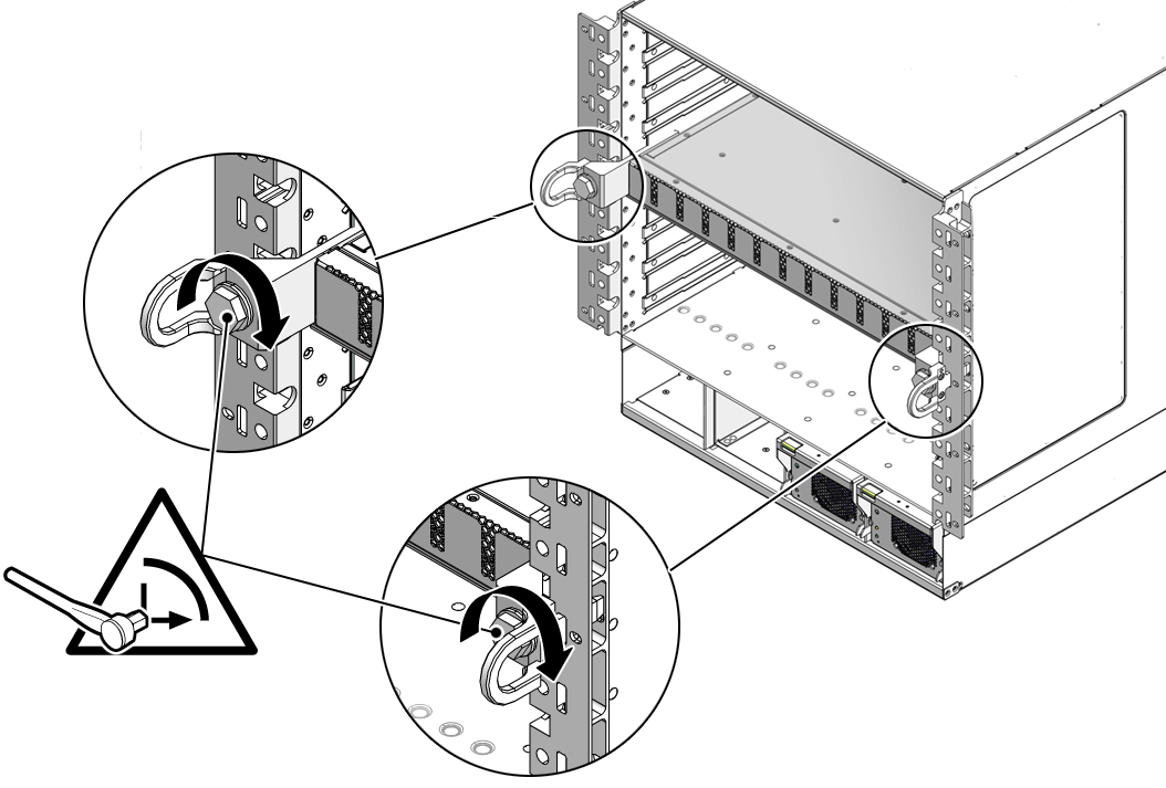

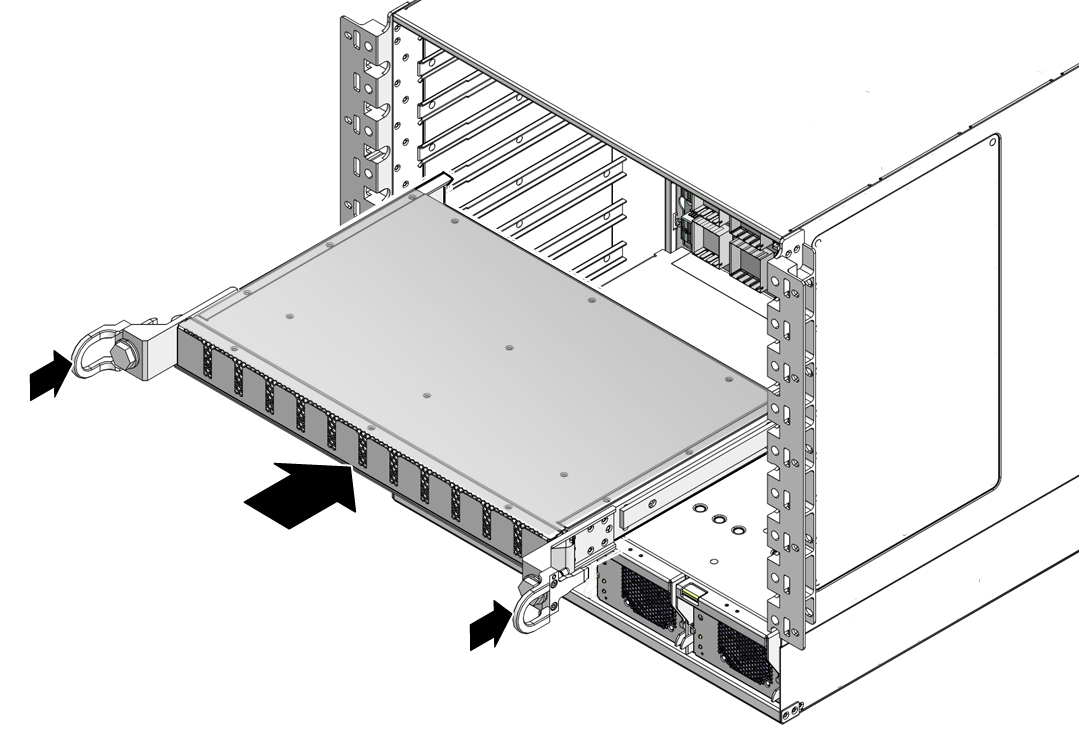

![]() | Caution - The midplane stiffener must be installed before the fabric cards are installed. |
To prevent damage to the pins of the midplane connectors, carefully align the stiffener with the midplane crossbar.
See the table in Installation Sequence.
Ensure that the stiffener is perpendicular to the surface of the midplane.
When you feel resistance in the retainer bolts, stop.
![]() | Caution - Do not turn the retainer bolts more than 1/4 revolution each time. Turning more than 1/4 turn damages the midplane stiffener and midplane XBOW connectors. |
