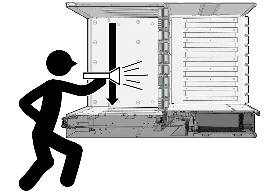

For this procedure, you need:
Flashlight
Magnifying glass
See the table in Installation Sequence.
Look at the pins straight on.
A bent pin reflects light differently, either brighter or darker than the surrounding pins.
Note - Do not look at the individual pins, rather look at all of the connector’s pins as a whole. A bent pin will be apparent.
These contaminants might appear as light dots near the pins.
