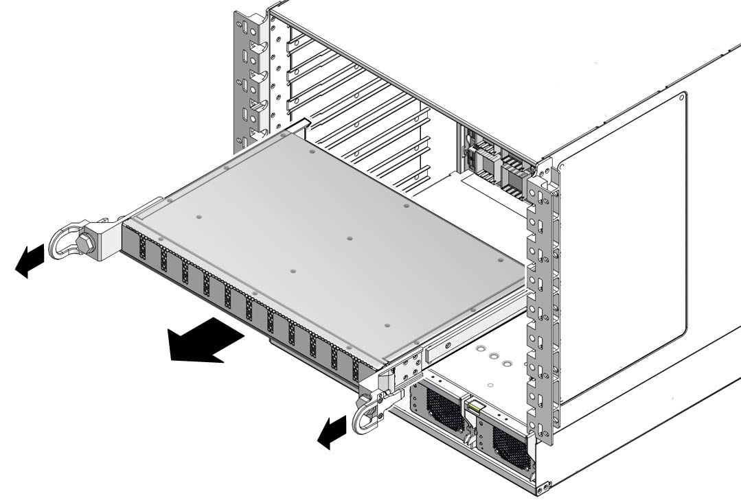

You must remove the midplane stiffener before installing the line cards.
See the table in Installation Sequence.

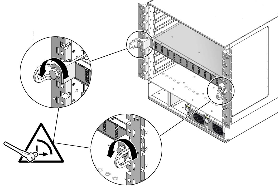

![]() | Caution - Do not turn the retainer bolts more than 1/4 revolution each time. Turning more than 1/4 turn damages the midplane stiffener and midplane XBOW connectors. |
