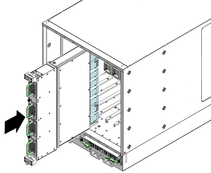

  2. Lift the fabric card from the work surface and orient it vertically, with the wide rail at the top and the narrow rail at the bottom.
  3. Insert the fabric card into the chassis at the vacant slot.
    Ensure that the fabric card is vertical.
    Illustration shows a fabric card being inserted.
    Note - Once the fabric card is about halfway into the slot, it is no longer necessary to bear the weight of the fabric card.
  4. Continue to slide the fabric card in, maintaining a vertical orientation.
    When you feel resistance, stop.

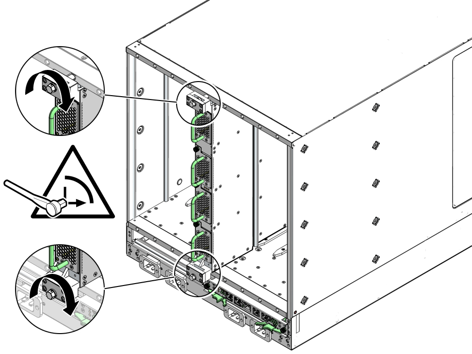

  5. While pressing the fabric card in with one hand, rotate the retainer bolts clockwise by hand so that they engage.
    When you feel resistance in the retainer bolts, stop.
  6. Using a 10 mm socket and ratchet, turn the lower retainer bolt 1/4 turn clockwise.
    Illustration shows the fabric card bolts being secured.
  7. Turn the upper retainer bolt 1/4 turn clockwise.
    Caution
    Caution - Do not turn the retainer bolts more than 1/4 revolution each time. Turning more than 1/4 turn damages the fabric card and midplane XBOW connectors.
  8. Repeat Step 6 and Step 7 about 12 times until you feel resistance to turning and the fabric card is flush to the rear of the chassis.
  9. Give each retainer bolt a torque of 2.0 ft-lb (0.27 kg-m).
  10. Turn the lower retainer bolt 1/4 turn counter-clockwise.
  11. Turn the upper retainer bolt 1/4 turn counter-clockwise.
  12. Repeat Step 10 and Step 11 twice to relieve board deflection.
  13. Verify that the fabric card is properly seated in the slot.
