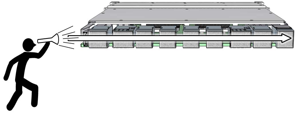

  2. Place the fabric card on a work surface with the XBOW connectors facing you.
  3. Using the flashlight positioned to the side and above you, look at the holes of the left-end connector.
    Look at the holes straight on.
    Illustration shows how to check the XBOW connectors on the fabric card.
    Note - Do not look at the individual holes, rather look at all of the connector’s holes as a group. A damaged or contaminated hole will be apparent.
  4. Look for any closed-over or contaminated holes.
    A closed-over or contaminated hole appears brighter than the surrounding holes.
  5. Look for any enlarged or cracked holes.
    An enlarged or cracked hole appears darker than the surrounding holes.
  6. Move your head slightly right to the next connector, and inspect its holes, repeating Step 4 and Step 5.
  7. Continue in this manner for each connector until you reach the right side of the fabric card.
