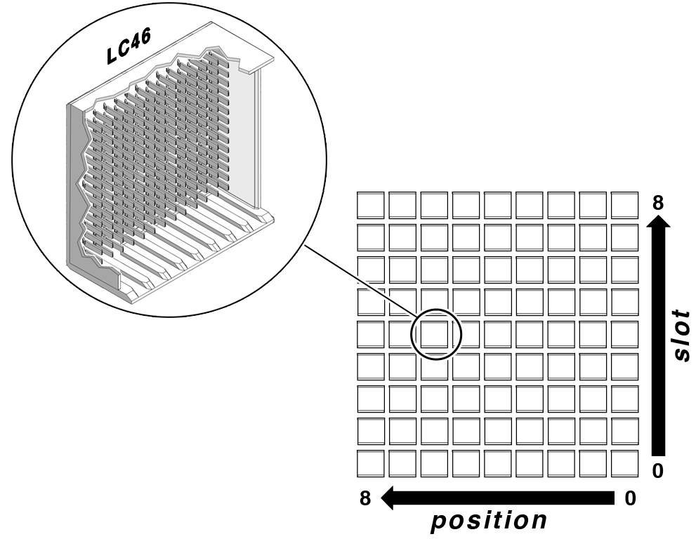

Midplane Line Card Connector Nomenclature
The front side of the midplane has an 9x9 matrix of XBOW connectors that interface with the line cards.
Illustration shows the line card XBOW connector nomenclature.
The unique connector number is located above each connector. For example, the lower-left connector number is LC08. The upper-right connector number is LC80. The connector number is decoded as LCslotposition. Where:
The origin of this coordinate system is the lower right corner, LC00. In the illustration, the connector identified is LC46.
