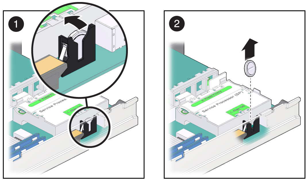

Remove the Battery
  1. Prepare for service.
    See Preparing for Service.
  2. Push the top of the battery forward, then lift the battery from the holder (panels 1 and 2).
    image:FIgure shows how to remove and replace the battery on the                                     server module motherboard.
  3. Install a new battery.
    See Install the Battery.
