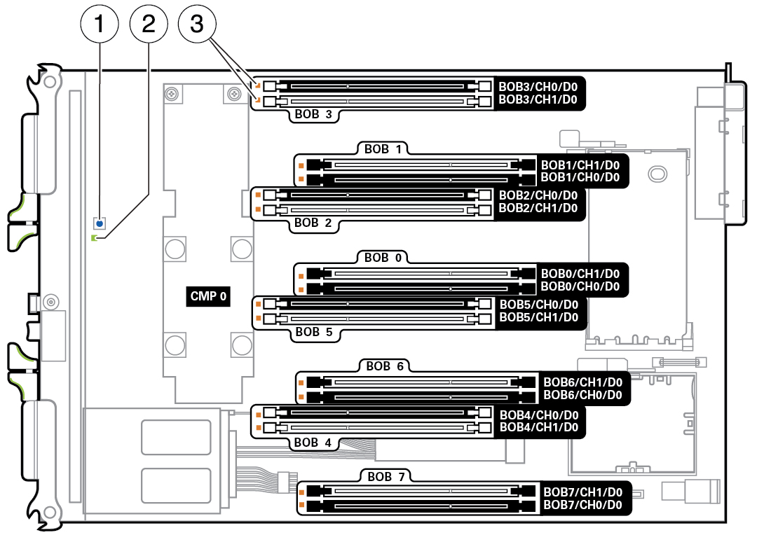

DIMM LEDs
image:FIgure showing the locations of the DIMMs, fault LEDs, fault remind                             button and LED.
No.
Description
1
Fault Remind button
2
Fault Remind Power LED
3
DIMM Fault LEDs
