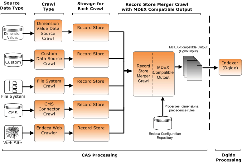

Although you can create a crawl of any data source type, the most common scenario is to create a Record Store Merger crawl that is configured to write MDEX-compatible output. The advantage of this type of crawl configuration is the capability to merge many types of data and then write output that can be directly processed by Dgidx without using Forge. For example, this data can include product inventory, product descriptions, extended product reviews, and so on.
Here is a diagram of a CAS crawl that uses a Record Store Merger crawl to read from five record store instances and then write MDEX-compatible output for use by Dgidx:
This high-level process consists of the following steps:
