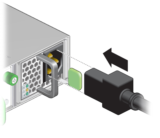

The AC LED lights green to indicate that the power supply is connected to facility power. A moment later, the OK LED lights green to indicate the power supply is at full power.
For example, to check the power supplies:
FabMan@switch_name->checkpower PSU 0 present status: OK PSU 1 present status: OK All PSUs OK FabMan@switch_name->
FabMan@switch_name->checkvoltages Voltage ECB OK Measured 3.3V Main = 3.28 V Measured 3.3V Standby = 3.40 V Measured 12V = 11.90 V Measured 5V = 4.99 V Measured VBAT = 3.01 V Measured 2.5V = 2.49 V Measured 1.8V = 1.78 V Measured I4 1.2V = 1.22 V All voltages OK FabMan@switch_name->
Switch Reference, checkpower command
Switch Reference, checkvoltages command
