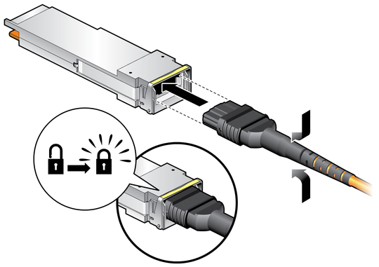

If the InfiniBand cables are unassembled, you must assemble the cables before attaching them to the switch.
Note - The ends of the optical fiber cable and the receptacles of the transceivers must be clean and optically clear before assembly. Do not remove the protective caps from the optical fiber cable or the plugs from the transceivers until instructed to do so.
You will need two QSFP optical transceivers and a fiber optic cable.
Note - The MTP connector and QSFP receptacle are keyed for proper fitting.
