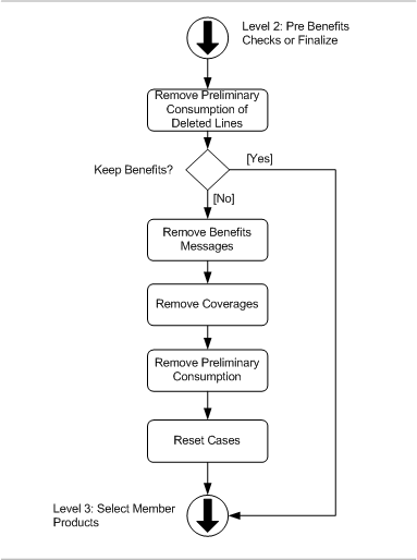

The clean up benefits results flow is schematically depicted by the following figure.
Clean Up Benefits Results
Level 3: Clean Up Benefits Results
The first step is to remove any preliminary consumption on the claim header. This is preliminary consumption that originally belonged to a deleted claim line.
The next step is to check per line whether that line’s benefit results remain untouched or whether they are going to be recalculated. A line is recalculated if the Locked indicator and the Keep Benefits indicator on the claim line are unchecked.
