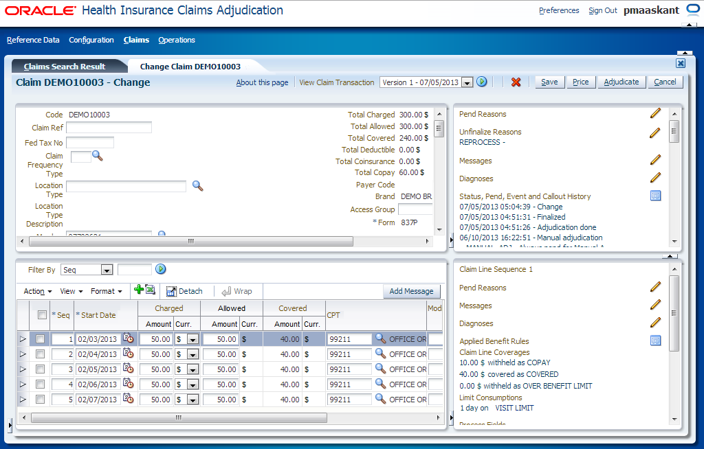

Change Claim
This page is used to edit existing claims that have the status 'change'. The retrieval and display of data in this page is subject to restrictions described in the implementation guide for user access.
This page can be accessed through the Claims Search Result page on one of the search results. This will open an instance of this page in a dynamic tab for that particular claim.
Display and Specifics
Change Claim
Changing Claims
While changing a claim, field values are not checked for time validity as of the service date. These validations are executed during processing, not while changing the claim.
