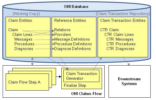

The following diagram illustrates the context of the claim transaction repository within Claims:
The claims flow steps create and update the claim entities (working copy) and when a claim is finalized a 'standalone' claim transaction is created with the details of claims and referenced entities that are required by downstream systems. The claim transaction data model is very similar to the model used during the processing of claims (working copy). The main differences between the models are:

The following diagram illustrates the context and main internal logic of the repository:

The generator builds a claim transaction 'representation' of a claim from the Claims working copy 'representation' of it using dynamic logic functions. The functions are created as part of system configuration. They transfer the values from claims in Claims and referenced data entities that are needed by any downstream application to the claim transaction. The functions transfer values to both the fixed and dynamic fields of the repository from the fixed and dynamic fields of claims in Claims. This allows flexibility in filling of all fields (fixed and dynamic). The dynamic logic for creating claim transactions is defined within the context of transaction creation scenarios. Different scenarios can be created for different types of claims.

Claims Transaction Repository
Data Model (Tables)
This component holds claim transactions. The details of a claim transaction in the repository are never updated, although an 'unfinalized' label can be added to a transaction. Dynamic fields may be added to the repository in a similar way as to how they can be added to the main claim entities (working copy). Note that the dynamic fields of the repository are not necessarily the same as the ones for the working copy. This is because the repository fields will often hold values from referenced entities in the repository claim entities. They would be fixed fields in the referenced entities but dynamic fields in the repository model. Likewise, dynamic fields on the referenced entities that are required in the repository would be defined on claim transaction entities as referenced entities are not in the repository (that is, they would be on different entities). Refer to the Dynamic Fields implementation guide for more details.
