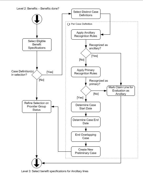

Select Benefit Specifications
The 'Select Benefit Specifications' level 3 flow shows how Claims selects the applicable benefit specification(s) for a claim line.
select benefit
The selection of benefit specifications includes all subtypes with the following exceptions:
  • The selection of reservation specifications happens in Reservation Selection, Claim Classification, and Episode Detection,so it is already done.
  • The selection of authorization specifications is not done for reservation lines (claim lines that belong to a claim with processing type Reservation) and also not for claim lines that refer to a reservation line. The rationale is that a customer will either make use of an authorization or of a reservation for a particular claim line, but not both.
The recognition and creation of adjudication cases is an integral part of the benefit specification selection step. An adjudication case is a grouping of claim lines that are adjudicated in the same way. Lines can either start a new case, or be added to an existing case. Lines that are added to an existing case are referred to as ancillary lines.
Lines are processed sequentially. However, a claim line that qualifies to be added to a case may be processed earlier than the line that actually starts that case. That means that, during the processing of the first line, there is no existing case that the line can be added to. This introduces a processing sequence challenge. For this reason, the benefit selection is executed in two phases.
The first phase selects the applicable benefit specification for all lines that do not qualify as a possible ancillary lines. If a candidate ancillary line is detected, it is flagged for the second phase. All lines in a claim go through this first selection before the second phase of the selection starts.
During the second phase, flagged lines are checked to see if they belong to an existing case. The possible outcome is that a line is added to an adjudication case that was created during phase one, even though the line that created the case has a higher sequence number. The second phase of the benefit selection is described in the Select Benefit Specifications for Ancillary Lines.
Within the scope of the flow depicted above, the steps are executed per claim line. The lines that meet one of the following conditions are ignored:
  • Lines with a checked "Keep Benefits" indicator;
  • Lines with a checked "Locked" indicator;
  • Lines that specify an overriding coverage regime (note that the selection of benefit specifications of type 'post benefits' is still performed for these lines; the evaluation of these benefit specifications takes place just as if no overriding coverage regime was sent in on the claim line);
  • Lines with a product independent fatal message (attached to the line itself or the bill or claim to which the line belongs) of the following origins: MANUAL, EXTERNAL, SANITY CHECKS, PRE PRICING, ENROLLMENT, RESERVATION, PRICING, PRICING LIMIT, PRICING NO RECALCULATION, PAYMENT STATUS or PRE BENEFITS.
The lines that specify an overriding coverage specification are also ignored. Here the overriding coverage specification is the only selected benefit specification (aside from the post-benefits). This benefit specification skips the filtering on the specified fields (see below). This means that even if, for example, the age range on the benefit specification does not match the age of the serviced person, the benefit specification is considered valid. No waiting period or authorization specifications are added to the list. The claim line follows a simplified case handling and skip provider network selection. See each of the steps for more details.
The lines are processed in order of their sequence attribute. The claim waits for all lines to pass through the flow before continuing to the next step, that is, selecting the benefit specifications for ancillary lines.

The end result of this processing step is a list of eligible benefit specification of all four subtypes, that is, waiting period, authorization, coverage and post benefits. If the claim line specifies an override coverage specification, this specification is not filtered on the conditions above. It is always considered to qualify.
The next section describes what happens if at least one of the eligible coverage benefit specifications specifies a case definition. If this is not the case, the claim line skips ahead to the "validate selection" step.
Select Distinct Case Definitions
All distinct case definitions specified on the eligible coverage specifications are selected. In the next steps, the selected case definitions are evaluated sequentially to attempt to recognize the current claim line as ancillary, primary or unrelated to the case.
If the claim line specifies an overriding coverage specification with a case definition, the line is attached to the case with the corresponding case definition as an ancillary line without evaluating the ancillary line recognition rules. If no such case exists, a new case instance is created and the line is added as a primary line without evaluating the primary line recognition rules. The next steps (Recognize Ancillary Lines and Recognize Primary Lines) are skipped for this claim line.

First, the system attempts to recognize the claim line as part of an existing case. A claim line that is added to an existing case is referred to as an ancillary line. All pre-existing adjudication cases that (1) belong to one of the case definitions selected in the previous step and (2) apply to the serviced person or object and (3) are valid on the claim line start date and (4) are not voided, are retrieved. These are adjudication case records that have been started by another claim line. For each retrieved case, all of the ancillary recognition rules are evaluated. Each ancillary recognition rule sets the following conditions:
  • If a procedure group is specified on the ancillary recognition rule, then:
    • If the usage is In, at least one of the three claim line procedures must be in that group on the claim line benefits input date.
    • If the usage is Not In, none of the claim line procedures may be in that group on the claim line benefits input date.
  • If a diagnosis group is specified on the ancillary recognition rule, then:
    • If the usage is In, the claim line primary diagnosis must be in that group on the claim line benefits input date.
    • If the usage is Not In, the claim line primary diagnosis may not be in that group on the claim line benefits input date.
  • If a dynamic condition is specified on the ancillary recognition rule, then it should evaluate as true.
If the current claim line meets all the conditions set by at least one of the ancillary recognition rules, then the line is recognized as a possible ancillary line to the case and the claim line is flagged for further evaluation in phase II; at this point no adjudication case details are created (yet).
Lines that have been flagged are precluded from the next step, i.e., the check to see if a line is a primary line. The rationale is that a line that qualifies to be added to an existing case and would also qualify to start a new case, is always added to the existing case.
Note that it is still possible for a line to be recognized as ancillary for a case with case definition A, while it is also recognized as primary for a case with case definition B. In this situation, further selection of the benefit specifications (for example, on provider status and priority) eventually determines which takes precedence.
If the claim line has not been recognized as belonging to an existing case, then Claims attempts to recognize the claim line as a primary line. A primary claim line is a line that starts a new case, rather than being added to an existing case.
For all selected case definitions for which the line was not recognized as ancillary, the following conditions are set:
  • If a procedure group is specified on the case definition, then:
  • If a diagnosis group is specified on the case definition, then:
  • If a dynamic condition is specified on the case definition, then it should evaluate as true.
If the line meets all conditions, then it is recognized as a primary line for the case. The start date and end date of the new case are set by the functions configured on the case definition, with the primary line serving as input. The end date is allowed to remain unspecified upon creation of the case. If no dynamic logic for the start date is specified, the following message is attached to the claim line:

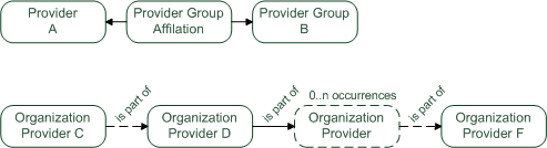

A provider is affiliated with a provider group if a provider group affiliation (valid on the claim line start date) exists between the provider and that provider group. In the image above, provider A is affiliated with provider group B.
select benefit specifications
An organization provider is a direct part of another organization provider if the organization provider refers to the other organization provider as its parent organization. Organization provider C is a direct part of organization provider D.
An organization provider is an indirect part of "parent" organization if the organization provider refers to a third organization which, in turn, is a direct or indirect part of the "parent" organization provider. In the image above, organization provider D is an indirect part of organization provider F (and any organization provider between organization provider D and F).
A provider is within the scope of a provider group if one of the following statements is true:
  • The benefits provider is affiliated with the provider group on the start date of the claim line;
  • The benefits provider is an organization provider and is a direct or indirect part of another organization provider that is affiliated with the provider group on the start date of the claim line;

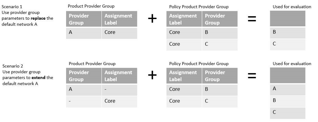

Assignment Labels
It is possible for provider groups to be included in the enrollment response payload in the form of policy product provider groups (refer to the Enrollment Call Out section of the Claims Flow guide for more information). If an assignment label is specified on a product provider group or a benefit specification provider group, then the system tries to find policy product provider groups for the policy product in context that have a matching assignment label and that are valid on the claim line benefits input date. If the system finds one or more applicable policy product provider groups, then those provider groups are used to determine the provider group status (instead of the provider group specified on the product provider group or benefit specification provider group record itself). So if for example a product provider group specifies provider group A and assignment label CORE and two policy product provider groups exist with assignment label CORE specifying provider groups B and C, then provider groups B and C are used to determine the provider group status, that is, they replace the default network A (depicted below in scenario 1). It is also possible to extend default network A with provider groups B and C as depicted in scenario 2 below.
product network parameter
If an assignment label is specified without a provider group on a product provider group or benefit specification provider group record and the system cannot find a policy product provider group with a matching assignment label that is valid on the claim line benefits input date, the following product dependent fatal message is attached to the claim line:

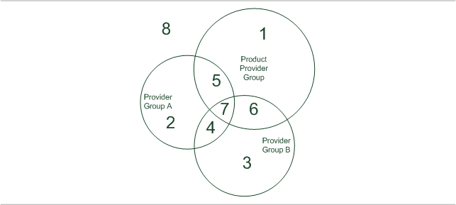

Example
To clarify the concept on filtering on provider group, consider the following example. The image below reflects a scenario with a single product provider group and a benefit specification with two benefit specification provider groups A en B. The numbers represent providers, the position of the number reflects the provider groups for which the provider group is considered to be within scope. For example, provider 4 is within scope of provider group B and is also in scope of provider group A, but is not within scope of the product provider group.
Provider Group Scope
The first and second column represent the way that the benefit specification is configured. The third column lists for which benefit providers the benefit specification is eligible, for example a benefit specification that has product group scope IN and specific group scope IN is eligible for claim lines with benefit providers 5, 6 or 7.
Product provider group scope Benefit spec provider group scope Applies to providers
IN
IN
5, 6 and 7
IN
OUT
1
OUT
IN
2, 3 and 4
OUT
OUT
8
EITHER
IN
2, 3, 4, 5, 6 and 7
EITHER
OUT
1 and 8

2. Product and benefit specification provider groups can be parametrized by using assignment labels; this is described in detail in the next section
