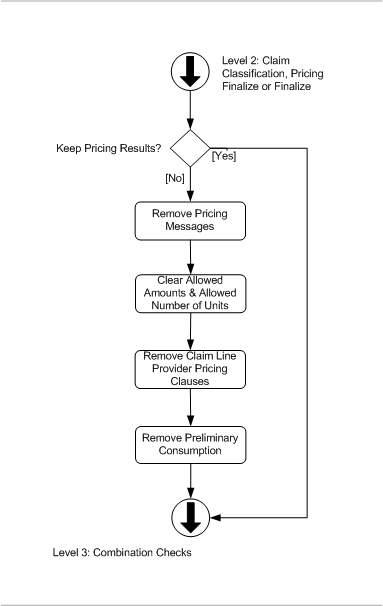

The clean up pricing results flow is schematically depicted by the following figure.
The first step is to check per line whether that line’s pricing results remain untouched or whether they are going to be re-alculated.

Lines That Are Re-Calculated
The results from an earlier pricing calculation are removed:
Claim, bill and claim line pricing messages (that is, messages with origin PRICING, PRICING LIMIT or PRICING NO RE-CALCULATION)
Note that claim and bill messages are only removed if at least one non-replaced and non-locked claim line has unchecked 'Keep Pricing' and 'Keep Benefits' indicators
The allowed amount (including the currency) of the claim line is cleared (set to null)
The allowed number of units of the claim line is cleared (set to null)
The claim line provider pricing clauses are removed
The indicator "Manual Pricing" on the claim line is unchecked
