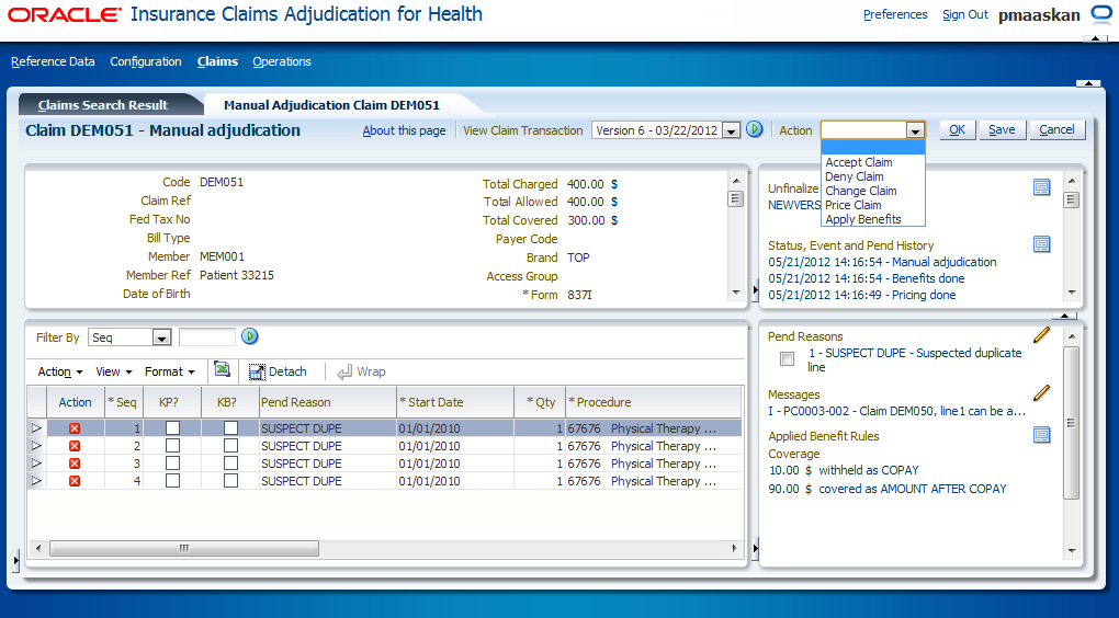

This page allows a user to manually accept or deny a claim or claim lines. The page shows the same information as is visible in the View Claim page, with additional fields in the claim line section specifically for manual adjudication.
This page can be accessed through the Claims Search Result page by clicking on the claim code link on one of the search results or the "Adjudicate" button in the View Claim page. This will open an instance of this page in a dynamic tab for that particular claim. Alternatively, this page can be access directly by the URL provided in the work flow notification message.
Display and Specifics
Manual Adjudication
This page displays only claims with the status MANUAL ADJUDICATION. The page allows a user to deny an entire claim, or one or more individual lines.

Denying a claim line
In the claim line section (3), the action column shows a deny icon. This icon appears unless the line[2] either:
  • already has a fatal product-independant message attached
  • already has a fatal product-dependant message attached, but one or more claim line rule coverages exist
Clicking this icon opens up a LOV with messages. The LOV is filtered to show fatal messages that are not system specific. Once the user has selected a message and has closed the LOV dialog, the deny icon disappears for that line. Denying a single line may affect the adjudication of other approved lines in the same claim. In order to make those changes apparent before accepting the claim, the user has the option to force a recalculation by saving the claim. Saving the claim causes a recalculation of the entire claim (except for locked claim lines and replaced claim lines):

Header Buttons
The following buttons are displayed on the top right of the local area:
Field Remark
View Claim Transaction
(drop menu)
Provides access to claim transactions of the current claim. The drop menu contains one line for each claim transaction in the claims transaction repository that originated from this claim.
Each entry shows the version number and transaction date. The most recent version is the default value. Versions are ordered by version number, most recent at the first entry.
Go
(Icon)
Opens the View Claim Transaction page for the selected Claim Transaction.
Change (button)
Closes this page and opens (in the same tab) the Enter Change Claim page.
Deny (button)
Opens an LOV on messages. The user is required to select a fatal message that is to be attached to the claim. Committing the selected fatal message closes this page and opens (in the same tab) the View Claim page. The claim continues processing.
Accept (button)
The claim continues processing. If all pend reasons are resolved, this page closes and the View Claim page opens (in the same tab).
A claim may only be accepted, when at least one change is made or when at least one outstanding pend reason is resolved. Also triggers the recalculation of the claim as described above.
