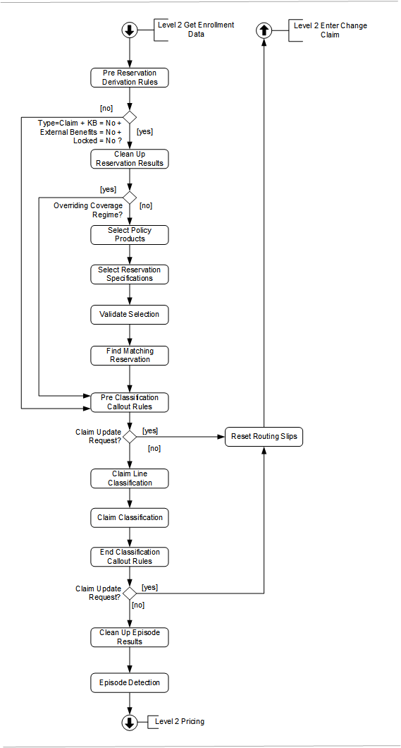

Reservation Selection, Claim Classification, and Episode Detection
The reservation selection step applies only to actual claims (not to quote claims or reservation claims) and detects whether the line requires a reservation. If so, it attempts to find and link the matching reservation line.
Claim Classification and Episode Detection are both instruments to flag a claim line and/or a claim in order to use those flags later on, typically during pricing. While the processing unit is - as always - the claim itself, the scope of both instruments are different. Claim Classification stays restricted to the claim at hand while Episode Detection often spans multiple claims.
Pre-Reservation Derivation Rules
Before the reservation selection starts, the application derives the two dates needed for benefit specification selection; the selection of reservation specifications in this flow uses these dates, as well as in the selection of the other benefit specifications (waiting period, authorization, coverage and post benefits) later in the flow.
Derivation rules are user configured rules that update the value of certain fields on a claim, bill or claim line. At this point in the flow, only execute derivation rules for which the step field has the value Pre-Reservation.
Evaluate the following pre-reservation process field derivation rules on the claim line:
claimLine.benefitsAgeInputDate
claimLine.benefitsInputDate
The required fields later in the claims flow are benefits age input date and benefits input date. If these fields are not set directly after the process field derivation rules, attached are the following fatal messages to the claim line, dependent on the missing attributes:
In this step the application attempts to find a reservation benefit specification that matches the claim line. Finding one means the claim line requires a reservation. Next, the application attempts to find that reservation, based on the configured reservation regime.
Skip this step for a reservation line, quote line, a locked claim line or a claim line with a checked keep benefits indicator or with a checked external benefits indicator. If an error is attaching to the claim line during reservation selection, it gets the origin RESERVATION.
The first step of claim classification is to determine which classification scheme to use, as described in the Pre-Pricing Checks.
If, as a result, on finding exactly one classification scheme, it is stored on the claim header and is now used to classify further. On finding a classification scheme, use this scheme to first classify claim lines one by one and then rolling up that information to the claim.

Episode Detection
Clean Up Episode Results
To clean up episode results, consider the below points:
Remove the results from a previous detection and therefore the episode details for claim lines within the claim are removed. Consequently, the information about the claim line previously acting as trigger, include or new is also removed
If a new claim line is getting created because of the previous detection, remove that claim line as well
The results from a previous detection are not removed for locked claim lines; these claim lines are still considered in the episode detection step
Episode Detection
Episode detection step is not executed if a product independent fatal message (of origin MANUAL, EXTERNAL, SANITY CHECKS, PRE-PRICING, ENROLLMENT or RESERVATION) is attached to the claim.
Claim lines having a product independent fatal message (of origin MANUAL, EXTERNAL, SANITY CHECKS, PRE-PRICING, ENROLLMENT or RESERVATION) are excluded from subsequent evaluation.
The episode detection sub step evaluates the configuration of episode definitions and episode criteria (see the Pricing Components Implementation Guide for description of the model) to determine if any one of them applies to the claim. Therefore, a new episode is created and one or more claim lines are identified belonging to the same episode (already existing or just created).
