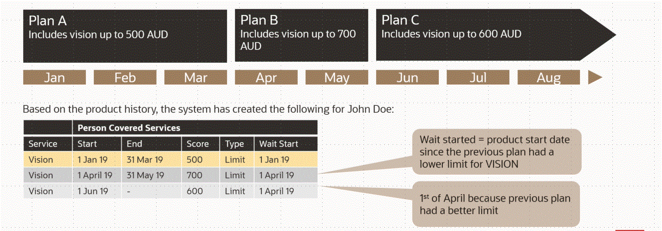

The image below displays enrollment data for member John Doe and the resulting person covered services. This example only specifies person covered services of service type Limit.

The system uses person covered services to decide if previous product enrollments can be used to serve the waiting period. If no person covered services exist for the member, the system does not check on previous products to determine the waiting period start date.
To find the waiting period start date from the person covered services the system selects the person covered services where
  • the product is the product in context
  • the service option service code is the service option service code on the product benefit specification
  • the claim line start date is between the start date and the end date of the person covered service.
The person covered service can be of two different types: Limit and Parameter. The wait period start date for the both can be different if one was upgraded, and the other downgraded when moving to a new product. For example, the new product has a higher cover limit, which is an upgrade, but also a higher copay, which is a downgrade. If this is the case, the system runs the following steps for both types separately.

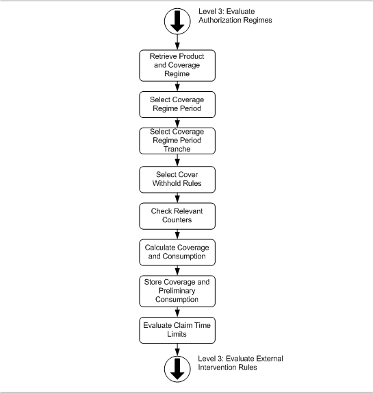

Next up is the coverage regime. The benefits input amount is required for the evaluation of coverage regimes. Because there might not have been an authorization regime it is checked again. If no benefits input amount is specified, then the following product independent message is attached to the line.
Code Sev Text
CLA-FL-BENS-010
Fatal
The calculation of this line requires the benefits input amount to be specified.
Before the evaluation, the claim line is checked for product specific fatal messages that apply to the same product as the coverage specification. If found, then the coverage regime evaluation stops. This ensures that claim lines that have attained a fatal message for the same product, for example during the gathering of enrollment data (if the product does not belong to the brand or payer specified by the claim) or during the evaluation and application of authorizations or waiting periods, are not evaluated for coverage.
If the claim line specifies an overriding coverage regime, the system uses the claim line product code to check on product specific fatal messages. If the claim line product code is empty, the system checks for fatal messages for the product with the highest priority in the list of policy products resulting from the Select Policy Products step. If found, the coverage regime evaluation stops.
Coverage benefit specifications that apply when the authorization is missing only make sense in combination with an authorization specification and a second coverage specification that applies when an authorization is found. If the authorization missing specification is the only one that turned up in the benefit selection, the following message is attached to the line:
Code Sev Text
CLA-FL-BENS-034
Fatal
Coverage for the claimed service assumes pre-authorization while the service does not require pre-authorization.
This situation suggests a configuration error; it does not make sense to set up a coverage benefit specification that covers the situation where no authorization is found, while there is no authorization benefit specification in the first place.
If an authorization was required, found and applied, yet there was no coverage benefit specification with an unchecked Authorization Missing? indicator, the following message is attached to the claim line:
Code Sev Text
CLA-FL-BENS-038
Fatal
Pre-authorization requirement applies while no coverage has been specified.
This situation also suggests a configuration error; it does not make sense to set up an authorization benefit specification, while there is no coverage benefit specification in the first place.
If there is an authorization requirement, it is possible that the benefits input amount is split over two coverage regimes. This happens when there is not enough space on the authorizations to cover the claim line in full, or if an unsatisfied authorization requirement applies to only a part of the claim line due to authorization regime tranches.
The regime on the coverage specification with an unchecked Authorization Missing? indicator, covers that part of the benefits input amount that either does not require an authorization, or has a satisfied authorization requirement.
The regime on the coverage specification with a checked Authorization Missing? indicator, covers that part of the benefits input amount that has an unsatisfied authorization requirement. If the claim line specifies an Overriding Coverage Regime (No Auth) that regime is used for that purpose.
After the evaluation of each coverage regime, it is checked if the benefits input amount is fully covered.
  • If it is not fully covered, then the coverage regime of the next coverage specification is evaluated. If there are no more coverage specifications listed, then the evaluation of coverage specifications is complete.

Evaluating a Single Coverage Regime
The following step is executed per claim line. This step describes the evaluation of the combination of a product and a coverage regime. The flow is schematically depicted by the following figure:
Evaluate Regimes

Calculate Coverage and Consumption
First the appropriate coverage regime period is selected, based on the claim line start date and the reference (date) of the regime. Next, the appropriate coverage regime tranche is selected based on prior charges within the selected period.
Once the tranche is selected, the underlying cover withhold rules are evaluated. For details on the calculation model and relevant scenarios see the description of the Coverage Regime Model in the implementation guide. If a coverage label is used that has a dynamic logic function that defines the input value for the calculation of a cover withhold rule, the output amount of this dynamic logic has to be in the same currency as the benefits input amount. If there is a mismatch in currencies, the following product dependent fatal message is attached to the claim line:

Product benefit specification values are time valid, so only product benefit specification values that are valid on the claim line benefits input date are evaluated.
If product benefit specification parameters apply and during waiting period evaluation the waiting period was served by a previous product, the lower of the parameter values from the two product benefit specfications must be used.
For example:
Product Limit Parameter Copay parameter
Previous product A
100 (= less)
100 (= better)
Current Product B
200 (= better)
200 (= less)
If the waiting period was served based on product B, use Limit 200 and Copay 200 If the waiting period was served based on previous product A: use Limit 100 and Copay 200 (worst of both worlds).

Evaluate Claim Time Limits
For every coverage providing product, the product claim time limit is evaluated. If a claim time limit is specified for the product, the start date of the claim line is compared to the receipt date of the claim. If the difference is more than the specified claim time limit, an informative message is attached to the claim line. Using external intervention rules, the claim may be pended for manual adjudication based on this message.
If the receipt date is empty, then no claim time limit evaluation is performed.

1. In this first explanation we discuss serving the waiting period as per product. Waiting periods from previous products can however differentiate per product, per service (also called modalities or clinical categories) and per service type (being Limit or Parameter)
2. In Policies this reference data is called Product Covered Services
3. also known as modality or clinical category
4. Member liabilities like copay or coinsurance
5. If the returned parameters do not match the parameters on the current product, for example because a parameter that is required in the current product is not configured on the previous product, the system raises a message when applying the parameter values during the cover calculation
6. If the product benefit specification does not specify a value for the parameters, the system returns the parameter values specified at the (previous) product level
7. The system checks if an authorization is applied by checking the preliminary authorization consumptions of the claim line; if at least one authorization with a checked Override Cover Limits indicator has been consumed, the cover stop limits are treated as continue limits.
