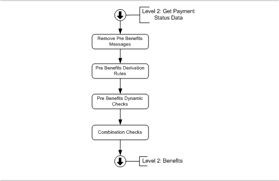

The pre benefits checks flow is schematically depicted by the following figure:
Remove Messages
The claim messages, bill messages and the claim line messages that were applied automatically in an earlier executed pre benefits step are removed. This includes messages that are attached to replaced lines.
Derivation Rules

Dynamic Checks
A dynamic check represents a (user configured) condition. If the claim or claim line fails to meet that condition, a message is attached. A dynamic check is executed on one of two points in the flow. The first moment is during the pre pricing checks. The second moment is during the pre benefits checks, as described here. At which of the two points a check executes depends on the way the check is configured.
It is not possible to configure claim (header) level pre benefits dynamic checks, so during this step only claim line level pre benefits checks are executed.
Dynamic checks executed during the pre benefits checks are typically dependent on information returned via the enrollment or payment status integration point. Dynamic checks are not evaluated if a product independent fatal message (of origin SANITY CHECKS, PRICING, PRICING LIMIT, PRICING NO RECALCULATION or ENROLLMENT) exists at the configured or higher level.
Combination Checks
Only combination checks with step 'Pre Benefits' are evaluated here. There are three types of combination checks: duplicate checks, mandatory checks & exclusive checks. Each type is described in the following paragraphs. All the combination checks in this step are executed at claim line level. For more information on combination checks refer to the Implementation Guide on Process Rules.
