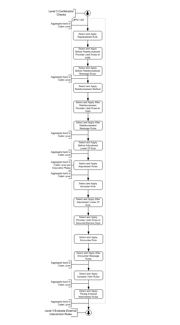

Select and Apply Reimbursement Method and Pricing Rules
The 'Select and Apply Reimbursement Method and Pricing Rules' level 3 flow shows the order of evaluation of the individual reimbursement methods and pricing rules.
As is apparent from the flow, the order of evaluation of the individual reimbursement methods and pricing rules is fixed and cannot be configured. It is possible however, that based on configuration a pricing rule is evaluated in a different place in the flow:
Before Reimbursement Provider Limit Rules in Units are evaluated in a place different from the After Reimbursement Provider Limit Rules in Units
Before Reimbursement Message Rules are evaluated in a place different from the After Reimbursement Message Rules
Before Adjustment Lower Of Rules are evaluated in a place different from the After Adjustment Lower Of Rules.
Then, how can we find all the provider pricing clauses that might have the right dimensions? We start by making the most obvious selections, that is look only at provider pricing clauses that reference a reimbursement method or pricing rule that is equal to the one that should be evaluated in the step at hand, for example, a Before Reimbursement Message Rule. Then a generic filter can take place which evaluates all the dimensions of the provider pricing clause itself against the claim line characteristics. After that a specific filter can be applied to take into account more dimensions that might be specified at the level of the reimbursement method or pricing rule or at one of its detail tables. As the last step we have to transform a list of possibly applicable provider pricing clauses into the one that should be applied, taking into account specificity, exemption and priority. All of these filters are described in Select Provider Pricing Clauses.
Aggregation
The sub-steps are executed per line. However, during several points in this flow, the lines are aggregated back to claim level. Such an aggregation point implies that a line must wait for all other lines to reach the aggregation point (within the same claim) before it can continue to the next step in the flow. There are multiple aggregation points:
The lines are aggregated back to claim level just before the sub-step Select and Apply Replacement Rules
The lines are aggregated back to claim level just after the sub-step Select and Apply Before Reimbursement Message Rules
The lines are aggregated back to claim level just after the sub-step Select and Apply After Reimbursement Message Rules
The lines are aggregated back to claim level just before the sub-step Select and Apply Adjustment Rules
The lines are aggregated back to claim level after every execution phase within the sub-step Select and Apply Adjustment Rules
The lines are aggregated back to claim level just before the sub-step Select and Apply Inclusion Rules
The lines are aggregated back to claim level just after the sub-step Select and Apply After Encounter Message Rules
The lines are aggregated back to claim level just before the sub-step Select and Apply Dynamic Field Rules
The lines are aggregated back to claim level after the sub-step Select and Apply Dynamic Field Rules
The lines are aggregated back to claim level after the last sub-step

Select all rate block sizes under the diminishing rate that either have no reference to a provider pricing clause, or refer to the selected provider pricing clause
Filter out all rate block sizes that are not valid on the price input date
Find the rate block with the lowest sequence
Find the rate block size tied to the rate block.
If there is both a rate block size with and without a reference to a provider pricing clause, pick the one with the reference
If there is no rate block size at the price input date (that is, it is the last rate block) continue with step 6
If the number of allowed units is greater than the rate block size:
Subtract the rate block size from the number of (remaining) allowed units
If a rate block with a higher sequence exists, repeat step 4 and 5 for the next rate block and with the remaining number of allowed units
Find the rate block amount tied to the current rate block valid on the price input date.
If there is both a rate block amount with and without a reference to a provider pricing clause, pick the one with the reference.
For a configuration having a specified block size on the last rate block, this effectively means that the calculation simply ignores that block size.
Apply the amount in the retrieved rate block amount to the claim line
Rate per unit, step-by-step execution
If configured to apply a rate per unit, the calculation aggregates the allowed amount as it sequentially evaluates the rate blocks. The calculation always starts with the first block; if the claim line allows more units than the size of the first block, then the excess units carry over to the calculation in the second block. If the line allows more units than the combined size of the first and second block, the excess units carry over to the third block and so on.
Select all rate block sizes under the diminishing rate that either have no reference to a provider pricing clause, or refer to the selected provider pricing clause.
Find the rate block with the lowest sequence. The aggregated allowed amount starts at zero
If there is both a rate block size with and without a reference to a provider pricing clause, pick the one with the reference.
Find the rate block amount tied to the current rate block. If there is both a rate block amount with and without a reference to a provider pricing clause, pick the one with the reference.
Multiply the amount with the rate block size and add the result to the aggregated allowed amount
Subtract the rate block size from the number of (remaining) allowed units.
If a rate block with a higher sequence exists, repeat step 4 and 5 for the next rate block and with the remaining number of allowed units.
Multiply the amount with the remaining allowed units and add the result to the aggregated allowed amount.
Apply the aggregated allowed amount to the claim line
This calculation logic can be hard work to comprehend. That’s why scenarios have been added in Diminishing Rates, which show how this algorithm leads to the final results, step by step.
Examples of Illogical configuration can lead to:
not finding a block at all
not finding a block amount at the price input date
All the illogical configuration will lead to the following product independent fatal message being attached to the claim line (the provider pricing clause is still tracked):
| Code | Sev | Text |
CLA-FL-PRIC-012  |
Fatal  |
Diminishing rate cannot resolve block size and/or block amount.  |
If the diminishing rate block amount currency differs from the claimed amount currency (if specified), product independent fatal message CLA-FL-PRIC-025 is attached to the claim line (see 'Allowed Amount and Number of Units' section).
Apply Payment Function
A payment function reimbursement method determines the allowed amount of a claim line by a mathematical function rather than a predefined contracted rate. When applicable, payment functions can use reference sheets to incorporate lists of weights and indices used in the calculation.
The payment functions returns the calculated claim line allowed amount based on the input parameters claim, claim line and provider pricing clause. The output of the function dynamic logic of the payment function is automatically (that is, by processing) multiplied by the percentage specified in the provider pricing clause; if no percentage is specified then the outcome remains unchanged.
If the configuration of the payment function does not return a value for the allowed amount - so that the outcome is a null value - the following product independent fatal message is attached to the claim line (the provider pricing clause is still tracked):
| Code | Sev | Text |
CLA-FL-PRIC-013  |
Fatal  |
Payment function calculation does not lead to a value for the allowed amount.  |
If the payment function returns an allowed amount currency that differs from the claimed amount currency (if specified), product independent fatal message CLA-FL-PRIC-025 is attached to the claim line (see 'Allowed Amount and Number of Units' section).
Select and Apply Lower Of Rules
After a provider pricing clause that references a lower of rule has been selected, the referenced rule is applied. The claim line claimed amount and the claim line allowed amount are compared. If the claimed amount is lower than the allowed amount, the claimed amount is set as the new allowed amount; else the allowed amount is not adjusted. The allowed number of units is not adjusted. If a message is specified on the lower of rule this message is attached to the claim line. The provider pricing clause and lower of rule that were applied and the impact on the allowed amount are tracked.
If the claim line claimed amount is not specified a product independent fatal message is attached to the claim line (the provider pricing clause is still tracked):
| Code | Sev | Text |
CLA-FL-PRIC-014  |
Fatal  |
Lower of rule cannot be applied, because the claim line does not specify a claimed amount  |
Lower of rules can be applied before or after adjustment rules, depending on the execution moment specified on the rule. The execution moment has no influence on how the lower of rule is applied; there is no difference in how before adjustment lower of rules and after adjustment lower of rules are applied.
After a provider pricing clause that references an adjustment rule (adjustment rule or combination adjustment rule) has been selected, the referenced rule is applied. The provider pricing clause and adjustment rule that were applied and the impact on the allowed amount are tracked.
'simple' adjustment rules are not evaluated (selected and applied) for claim lines that meet one of the conditions as described in the 'Prevent Evaluation' part at the top of this document. Combination adjustment rules evaluate all claim lines of a claim together; claim lines that meet one of the conditions as described in the 'Prevent Evaluation' part are not evaluated (except claim lines with a checked locked, keep pricing or keep benefits indicator which are evaluated to determine the primary, secondary and tertiary claim lines but the combination adjustment rules are not applied to these claim lines).
See Adjustment Rules for examples on how adjustment rules and combination adjustment rules are evaluated.
An adjustment rule can specify a formula dynamic logic. If specified, this dynamic logic is used to calculate the new allowed amount. An example of a formula dynamic logic can be found in the Implementation Guide for Dynamic Logic in the section on functions and in Adjustment Rules. If the adjustment rule function returns an allowed amount currency that differs from the current allowed amount currency, product independent fatal message CLA-FL-PRIC-026 is attached to the claim line (see 'Allowed Amount and Number of Units' section).
If a formula dynamic logic is not specified, the allowed amount is calculated by multiplying the previous allowed amount (the allowed amount up till the moment of adjustment through the adjustment rule) with a percentage. This percentage can be either the percentage specified as quantifier in the applied provider pricing clause, or the adjustment rule’s percentage that is valid at the price input date. The percentage specified as quantifier in the applied provider pricing clause takes precedence over the adjustment rule’s percentage. A product independent fatal message is attached to the claim line, if both the provider pricing clause does not specify a percentage and the adjustment rule does not have a percentage that is valid at the price input date (the provider pricing clause is still tracked):
| Code | Sev | Text |
CLA-FL-PRIC-010  |
Fatal  |
{adjustmentRule} cannot be applied, because neither the Provider Pricing Clause nor the {adjustmentRule} itself specifies an adjustment percentage (valid at the price input date).  |
If the adjustment rule was applied successfully, the message specified on the adjustment rule (if any) is attached to the claim line. The allowed number of units is not adjusted.
Apply Combination Adjustment Rule
A combination adjustment rule takes all claim lines of a claim into account, recognizing some as primary, some as secondary and some as tertiary (see Select Provider Pricing Clauses). Three dynamic logic formulas can be applied, one to calculate the allowed amount of primary claim lines, one to calculate the allowed amount of secondary claim lines and one to calculate the allowed amount of tertiary claim lines (primary line formula, secondary line formula and tertiary line formula).
If a primary line formula dynamic logic is specified, this dynamic logic is used to calculate the new allowed amount of the primary lines. If a primary line formula dynamic logic is not specified the allowed amount of the primary lines is not adjusted. If a secondary line formula dynamic logic is specified, this dynamic logic is used to calculate the new allowed amount of the secondary lines. If a tertiary line formula dynamic logic is specified, this dynamic logic is used to calculate the new allowed amount of the tertiary lines.
If a secondary line formula dynamic logic is not specified the allowed amount of the secondary lines is calculated by multiplying the previous allowed amount (the allowed amount up till the moment of adjustment through the combination adjustment rule) with a percentage. This percentage can be either the percentage specified as quantifier in the applied provider pricing clause, or the combination adjustment rule’s percentage for secondary line category that is valid at the price input date. The percentage specified as quantifier in the applied provider pricing clause takes precedence over the combination adjustment rule’s percentage.A product independent fatal message is attached to the claim line, if both the provider pricing clause does not specify a percentage and the combination adjustment rule does not have a percentage that is valid at the price input date (the provider pricing clause is still tracked):
| Code | Sev | Text |
CLA-FL-PRIC-010  |
Fatal  |
{combinationAdjustmentRule} cannot be applied, because neither the Provider Pricing Clause nor the {combinationAdjustmentRule} itself specifies an adjustment percentage (valid at the price input date).  |
The attachment of fatal message CLA-FL-PRIC-010 to secondary claim lines does not have impact on the primary claim lines.
If a tertiary line formula dynamic logic is not specified the allowed amount of the tertiary lines is calculated by multiplying the previous allowed amount (the allowed amount up till the moment of adjustment through the combination adjustment rule) with the combination adjustment rule’s percentage for tertiary line category that is valid at the price input date. If the combination adjustment rule does not have a percentage that is valid at the price input date the rule is not applied to the claim line (in this situation message CLA-FL-PRIC-010 is not attached to the claim line and the provider pricing clause is not tracked).
Not applying the rule to tertiary claim lines (as described above) does not have impact on the primary and secondary claim lines. This is illustrated with scenario 8 in Adjustment Rules.
If the combination adjustment rule function returns an allowed amount currency that differs from the current allowed amount currency, product independent fatal message CLA-FL-PRIC-026 is attached to the claim line (see 'Allowed Amount and Number of Units' section).
If the combination adjustment rule was applied successfully, the message specified on the combination adjustment rule (if any) is attached to the claim line. The allowed number of units is not adjusted.
After a provider pricing clause that references an inclusion rule has been selected, the referenced rule is applied. The message that is specified on the inclusion rule is attached to the claim lines that are recognized as included claim lines; this message is not attached to claim lines that are recognized as global claim lines. The provider pricing clause and inclusion rule that were applied and the impact on the allowed amount are tracked for both the global and included claim lines.
Inclusion rules evaluate all claim lines of a claim together; claim lines that meet one of the conditions as described in the 'Prevent Evaluation' part at the top of this document are not evaluated (with the exception of claim lines with a checked locked, keep pricing or keep benefits indicator which are evaluated to determine the global and included claim lines but the inclusion rules are not applied to these claim lines).
See Inclusion Rules for examples on how inclusion rules are evaluated.
Select and Apply Encounter Rule
First the encounter indicator on the claim line is set to 'No'. Then, if a provider pricing clause that references an encounter rule has been selected, the referenced rule is applied. The encounter indicator on the claim line is set to 'Yes'. If a message is specified on the encounter rule this message is attached to the claim line. The provider pricing clause and encounter rule that were applied and the impact on the allowed amount are tracked.
After a provider pricing clause that references a dynamic field rule has been selected, the referenced rule is applied. The values of dynamic fields on the claim, bill or claim line (depending on the level specified on the rule) are set using the specified dynamic logic function. If a message is specified on the dynamic field rule this message is attached to the claim line. The provider pricing clause and dynamic field rule that were applied and the impact on the allowed amount are tracked.
Dynamic field rules are evaluated per claim; first all eligible dynamic field rules (all levels [3]) are selected, then the rules are applied per level of the rule in the following order: claim, bill, claim line. This means that if for example multiple claim lines within a claim trigger the same claim level dynamic field rule, the dynamic logic function of the rule is only executed once. In this case tracking and attaching the dynamic field rule message (if specified) is done for all triggering claim lines.
Select and Apply Pricing External Intervention Rules
After a provider pricing clause that references a pricing external intervention rule has been selected, the referenced rule is applied; whether a pend is depends on the suppress when fatal indicator. For each triggered pricing external intervention rule, the specified pend reason is checked: if the re-attach indicator is unchecked and the pend reason history indicates that the same pend reason has been previously attached on the claim line, then the pend reason is not attached and the claim will not pend because of this pricing external intervention rule. Otherwise, the specified pend reason is attached to the claim line, and added to the claim pend reason history. As a result, the claim status is set to MANUAL PRICING.
Pricing external intervention rules are evaluated (selected and applied) regardless if a fatal message of any origin except 'SANITY CHECKS' exists on the claim line (directly or inherited). They are evaluated at the price input date of - if the price input date is not specified as yet - the claim line start date. The provider pricing clause and pricing external intervention rule that were applied are tracked. As of the nature of the rule, there can be no impact on the allowed amount.
Also, the 'normal' external intervention rules are evaluated whether a pricing external intervention rule leads to a pend; this is to prevent that only the second time around one would be notified of a 'normal' pend thus leading to resolving twice.
The messages attached in this sub-step have origin PRICING NO RECALCULATION. The following messages can be attached in this sub-step:
Messages specified on the pricing external intervention rules
Messages specified on the provider pricing clauses related to the applied pricing external intervention rules
System generated message CLA-FL-PRIC-006 (see Select and Apply Reimbursement Method and Pricing Rules)
