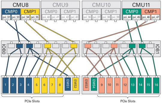

Half-Populated DCU2 PCIe Slot Root Complexes
This illustration shows the PCIe I/O fabric paths from each root complex to the PCIe and EMS slots in a half-populated DCU2. A half-populated DCU2 contains only CMU8 and CMU11.
image:Figure showing the root complexes for a half-populated DCU2.
This table lists information for each PCIe and EMS slot in a half-populated DCU2.
Slot
Root Complex
CMU No./CMP No.
Device Path
FRU Path
PCIe 1
pci_33
CMU8/CMP0
/pci@b40/pci@1/pci@0/pci@8
/SYS/IOU2/PCIE1
PCIe 2
pci_33
CMU8/CMP0
/pci@b40/pci@1/pci@0/pci@2
/SYS/IOU2/PCIE2
PCIe 3
pci_32
CMU8/CMP0
/pci@b00/pci@1/pci@0/pci@6
/SYS/IOU2/PCIE3
PCIe 4
pci_32
CMU8/CMP0
/pci@b00/pci@1/pci@0/pci@4
/SYS/IOU2/PCIE4
PCIe 5
pci_34
CMU8/CMP1
/pci@b80/pci@1/pci@0/pci@8
/SYS/IOU2/PCIE5
PCIe 6
pci_34
CMU8/CMP1
/pci@b80/pci@1/pci@0/pci@2
/SYS/IOU2/PCIE6
PCIe 7
pci_35
CMU8/CMP1
/pci@bc0/pci@1/pci@0/pci@6
/SYS/IOU2/PCIE7
PCIe 8
pci_35
CMU8/CMP1
/pci@bc0/pci@1/pci@0/pci@4
/SYS/IOU2/PCIE8
PCIe 9
pci_47
CMU11/CMP1
/pci@ec0/pci@1/pci@0/pci@8
/SYS/IOU2/PCIE9
PCIe 10
pci_47
CMU11/CMP1
/pci@ec0/pci@1/pci@0/pci@2
/SYS/IOU2/PCIE10
PCIe 11
pci_46
CMU11/CMP1
/pci@e80/pci@1/pci@0/pci@6
/SYS/IOU2/PCIE11
PCIe 12
pci_46
CMU11/CMP1
/pci@e80/pci@1/pci@0/pci@4
/SYS/IOU2/PCIE12
PCIe 13
pci_44
CMU11/CMP0
/pci@e00/pci@1/pci@0/pci@8
/SYS/IOU2/PCIE13
PCIe 14
pci_44
CMU11/CMP0
/pci@e00/pci@1/pci@0/pci@2
/SYS/IOU2/PCIE14
PCIe 15
pci_45
CMU11/CMP0
/pci@e40/pci@1/pci@0/pci@6
/SYS/IOU2/PCIE15
PCIe 16
pci_45
CMU11/CMP0
/pci@e40/pci@1/pci@0/pci@4
/SYS/IOU2/PCIE16
EMS1
pci_32
CMU8/CMP0
/pci@b00/pci@1/pci@0/pci@c
/SYS/IOU2/EMS1
EMS2
pci_34
CMU8/CMP1
/pci@b80/pci@1/pci@0/pci@0
/SYS/IOU2/EMS2
EMS3
pci_46
CMU11/CMP1
/pci@e80/pci@1/pci@0/pci@c
/SYS/IOU2/EMS3
EMS4
pci_44
CMU11/CMP0
/pci@e00/pci@1/pci@0/pci@0
/SYS/IOU2/EMS4
