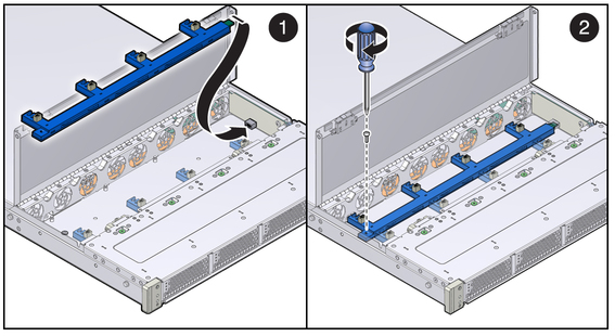

Install a Fan Board
  1. Install the fan board:
    1. Lower the board into the slot and slide it to the right to secure it to the connector board as shown in panel 1 of Installing a Fan Board.
    2. Using a No. 1 Phillips screwdriver, insert and tighten the screw that secures the fan board to the as shown in panel 2 of Installing a Fan Board.
      Figure 30 Installing a Fan Board
  2. Close the fan module cover.
  3. Return the system to the installed position.
    Refer to Return the System to the Fully Installed Position.
  4. Reconnect any cables that were disconnected before the boards were removed.
  5. Restore power to the system.
    Refer to Power On the System.
