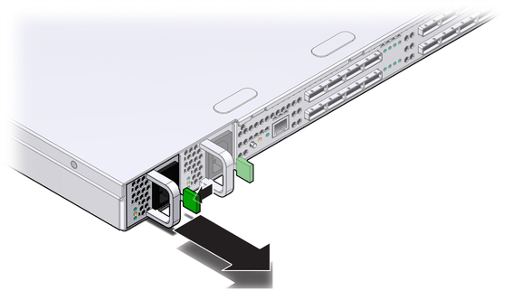

Note - This component is hot swappable and customer replaceable.
  1. Identify which power supply you will replace.
    Each power supply has one fault LED that you can view from the rear of the chassis. If the amber LED is illuminated, the power supply should be replaced.
  2. Disconnect the AC power cord from the power supply that you are replacing.
    You do not have to shut down the array or disconnect the other power supply.
  3. Remove the power supply.
    Press the release latch and slide the power supply out as shown in Removing a Power Supply.
    Figure 25 Removing a Power Supply
    Image show s how to remove a power supply.
