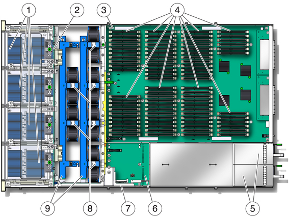

System Components shows the locations of the Sun Storage F5100 Flash Array components.
Figure 21 System Components
Figure Legend
1 ESMs (4)
2 ESB
3 Motherboard assembly
4 Flash Modules (FMods) (80)
5 PSUs (2)
6 PDB
7 Connector board
8 Fan modules (6), total of 12 fans
9 Fan board assemblies (2)
