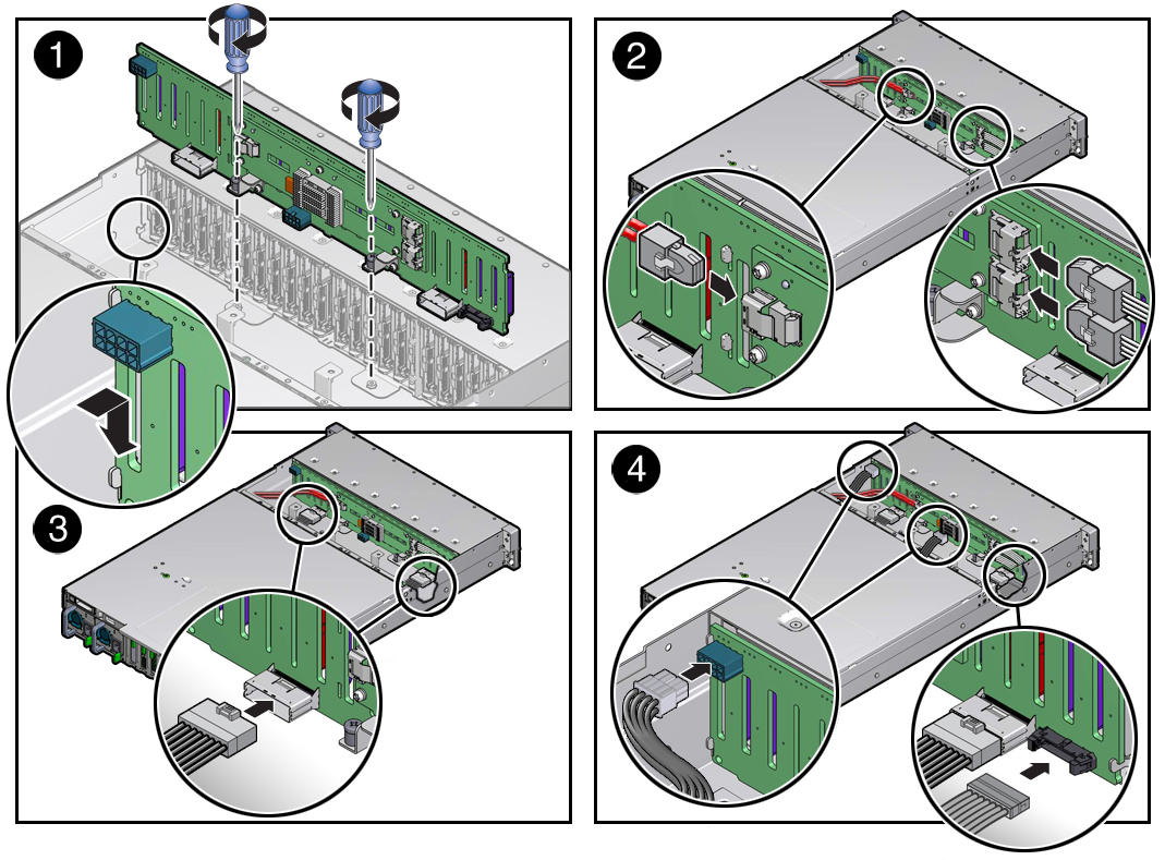

  1. Lower the storage drive backplane into the server, and position it to engage the standoff hooks [1].
    image:Figure showing the storage drive backplane being installed in                                 the server.
  2. Using a No. 2 Phillips screwdriver, install and tighten the two spring-mounted screws to secure the storage drive backplane to the chassis [1].
  3. Reconnect the cables to the storage drive backplane.
    1. Reconnect the SAS cable to the storage drive backplane from the rear-mounted storage drives, and the two SAS cables to the storage drive backplane from the Oracle Storage 12 Gb/s SAS PCIe RAID HBA [2].
      To ensure proper SAS cable connections, see Install SAS Storage Drive Cables.
    2. If present, reconnect the two optional NVMe cables to the storage drive backplane [3].
      To ensure proper NVMe cable connections, see Install NVMe Cables.
    3. Reconnect the two power cables and the auxiliary signal cable to the storage drive backplane [4].
