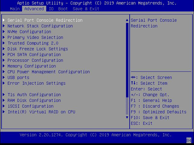

BIOS Advanced Menu Selections
This section includes a screen of the BIOS Advanced Menu. The options that are
available from the Advanced Menu are described in the sections that follow. Options in
the tables that are marked as “(R/O)” are read-only information and cannot
be changed.

BIOS Advanced Menu Memory Configuration Option
The following table describes the BIOS Advanced Menu memory configuration
option.
Numa
Enabled/Disabled
Enabled
Enable or disable Non Uniform Memory Access (NUMA).
