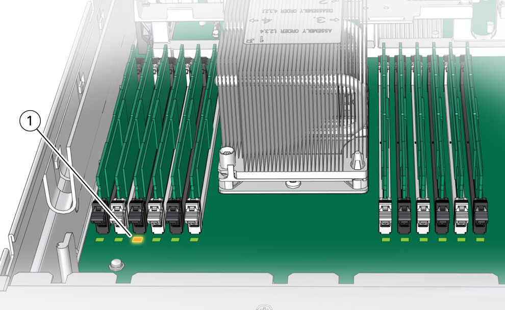

  2. Identify and note the location of the failed DIMM by pressing the Fault Remind button on the motherboard.
    See Using the Server Fault Remind Button.
    Failed DIMMs are identified with a corresponding amber LED on the motherboard.
    • If the DIMM Fault LED is off, then the DIMM is operating properly.
    • If the DIMM Fault LED is on (amber), then the DIMM is failed and should be replaced [1].

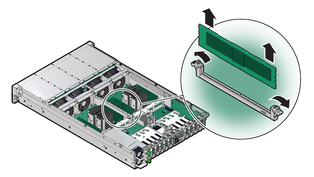

  3. To remove the failed DIMM, do the following:
    1. Rotate both DIMM slot ejectors outward as far as they will go.
      The DIMM is partially ejected from the slot.
    2. Carefully lift the DIMM straight up to remove it from the slot.
      image:Figure showing a memory DIMM being removed from the                                     server.
