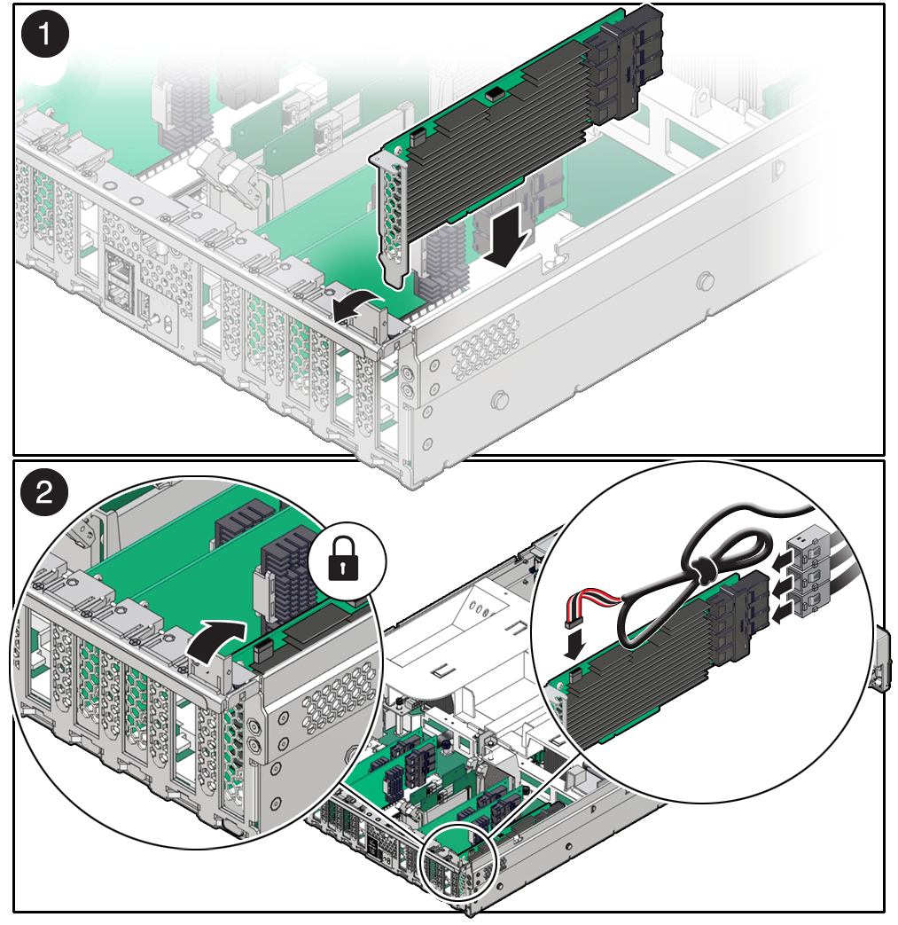

  2. Insert the internal HBA card into PCIe slot 11, and rotate the PCIe locking mechanism to secure the PCIe HBA card in place [1 and 2].
    Note -  PCIe slot 11 is the primary slot for the internal HBA card. The card is required for controlling and managing the SAS storage drives.
    image:Figure showing the internal HBA card being installed into the                             server.
  3. Connect the super capacitor cable to the internal HBA card, and then reconnect the SAS cables that you unplugged during the removal procedure [2].
    To ensure proper SAS cable connections, see the SAS cabling reference table in Step 3 in Install SAS Storage Drive Cables.

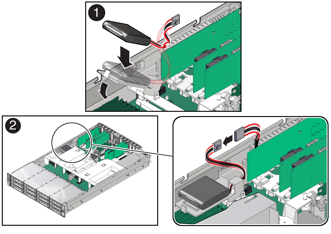

  4. Install the HBA super capacitor in the chassis.
    Note -  If you did not remove the HBA super capacitor when removing the internal HBA card, reconnect the HBA super capacitor cable to the internal HBA card.
    1. Apply a recloseable fastener to the underside of the super capacitor.
    2. Align the recloseable fastener on the super capacitor with the recloseable fastener on the HBA super capacitor tray and press down [1].
      image:Figure showing the installation of the HBA super                                     capacitor.
    3. Route the super capacitor cable through the tray wire guide on the HBA super capacitor tray and then connect the super capacitor cable [2].
