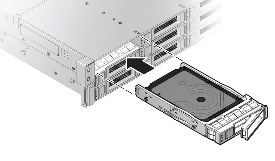

  3. Align the replacement drive with the drive slot.
    The drive is physically addressed according to the slot in which it is installed. It is important to install a replacement drive in the same slot as the drive that was removed.
  4. Slide the drive into the slot until the drive is fully seated.
    image:Figure showing a storage drive being installed in the                                 server.
  5. Close the drive latch to lock the drive in place.
