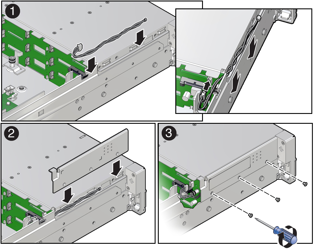

  1. Install the temperature sensor by carefully inserting the sensor-end of the cable through the rear opening of the cable trough. Then pull the cable through the opening and install it into the cable trough along the left side of the chassis [1].
    image:Figure showing the temperature sensor being installed into the                             chassis.
  2. Install the FIM cable and Temp Sensor Access cover to the chassis by inserting it into the FIM cable and Temp Sensor Access cover slot [2].
  3. Install the three No. 2 Phillips screws to secure the FIM cable and Temp Sensor Access cover to the chassis [3].

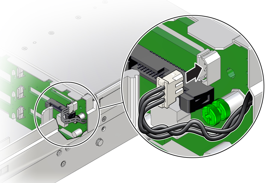

  4. Reconnect the temperature sensor cable to the disk backplane.
