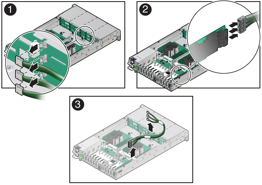

  2. Disconnect the SAS cables from the disk backplane [1].
    Press the green button on the connector while gently pulling the connector from the disk backplane.
    image:Figure showing SAS drive cables being removed from the                             server.
  3. Disconnect the SAS cables from the Oracle Storage 12Gb SAS PCIe RAID HBA, Internal card in PCIe slot 11 [2].
    Press each latch, and then pull out to disengage the cable from each connector. See also Remove the Internal HBA Card and HBA Super Capacitor.
    Note -  If your server is configured with Oracle Storage 12 Gb SAS PCIe HBA, Internal (non-RAID) cards, disconnect the SAS cables from the Oracle Storage 12 Gb SAS PCIe HBA, Internal cards located in PCIe slots 10 and 11.
  4. Remove the SAS cables from the server [3].
    Carefully remove the SAS cable bundles from the server. Be careful not to snag the cables on the server components.
