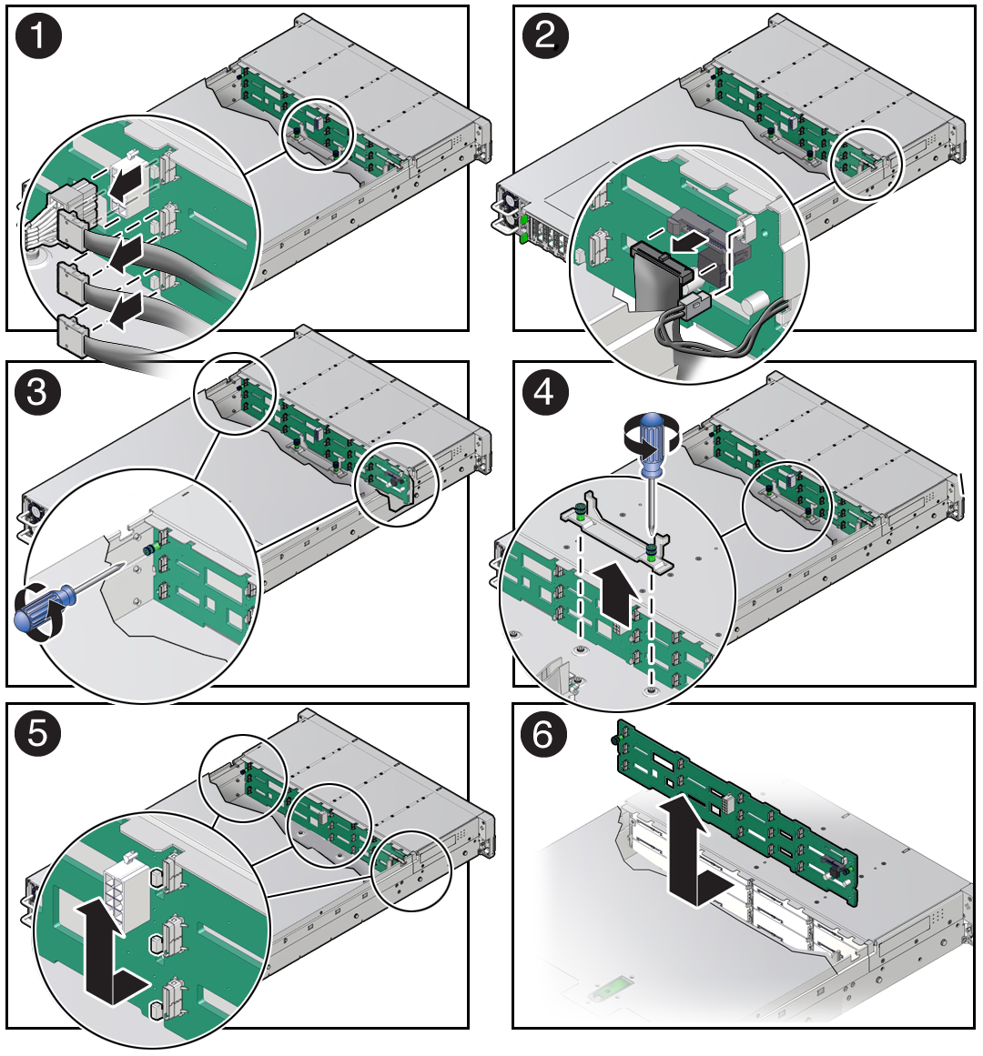

  3. Disconnect the cables from the disk backplane.
    1. Disconnect the power cable from the disk backplane [1].
    2. Depending on your storage drive configuration, do one of the following:
      • Disconnect the three SAS cables from the disk backplane [1].
        Press the green button on the connector while gently pulling the connector from the disk backplane. Note the cable connections in order to ease proper reconnection of the cables.
      • Disconnect the twelve NVMe cables (not shown) from the disk backplane [1].
      image:Figure showing the disk backplane being removed                                     from the server.
    3. Disconnect the temperature sensor cable from the disk backplane [2].
    4. Disconnect the auxiliary signal cable from the disk backplane [2].
  4. Using a Torx T15 screwdriver, loosen the right-side and left-side spring-mounted screws that secure the disk backplane to the chassis [3].
  5. Using a Torx T25 screwdriver, loosen the spring-mounted screws that secure the backplane bracket to the chassis, then lift the bracket from the server [4].
  6. Lift the disk backplane up to release it from the standoff hooks and out of the chassis [5 and 6].
  7. Place the disk backplane on an antistatic mat.
