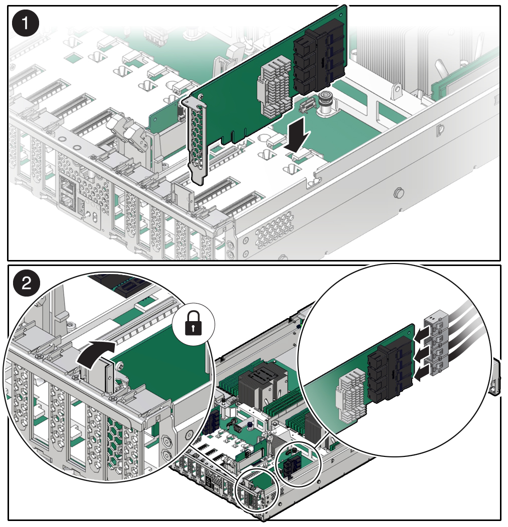

  4. Insert the PCIe card into the correct slot [1], and rotate the PCIe locking mechanism downward to secure the PCIe card in place [2].
    You will hear an audible click when the PCIe card is secured into the slot.
    image:Figure showing a PCIe card being installed into the                             server.
  5. Reconnect the cables to the PCIe card that you unplugged during the removal procedure [2].
    Note -  To ensure proper NVMe cable connections for Oracle PCIe NVMe switch cards, see the NVMe cabling reference table in Step 3 in Install NVMe Cables, and perform the procedures in Verify NVMe Cable Connections. To ensure proper SAS cable connections for Oracle Storage 12 Gb SAS PCIe HBA, Internal cards, see the SAS cabling reference table in Step 3 in Install SAS Storage Drive Cables.
