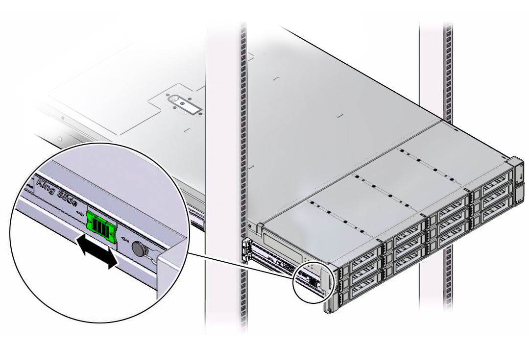

  1. Push the server back into the rack, as described in the following steps.
    1. Simultaneously pull and hold the two green release tabs (one on each side of the slide rails on the server) toward the front of the server while you push the server into the rack.
      As you push the server into the rack, verify that the cable management arm (CMA) retracts without binding.
      Note -  To pull the green release tab, place your finger in the center of the tab, not on the end, and apply pressure as you pull the tab toward the front of the server.
      image:Figure showing the location of the release tabs on the                                     slide-rails.
    2. Continue pushing the server into the rack until the slide-rail locks (on the front of the server) engage the slide-rail assemblies.
      You will hear an audible click when the server is in the normal rack position.
