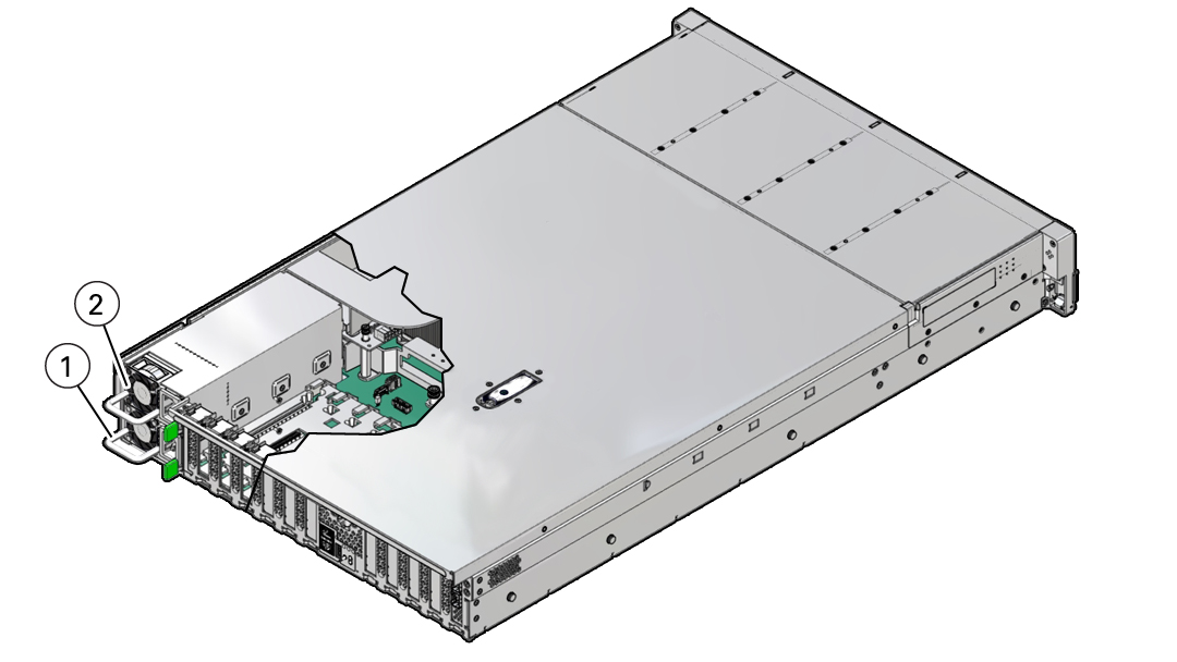

  2. Identify which power supply requires replacement.
    image:Figure identifying PS0, PS1, and their latches.
    Callout
    Description
    1
    Power supply 0
    2
    Power supply 1
    A lit amber Fault-Service Required LED on a power supply indicates that a failure was detected. You can also use the Oracle ILOM show faulty command at the Oracle ILOM command-line prompt (->) to identify a power supply failure.

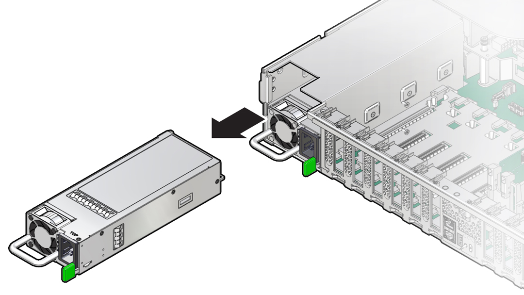

  5. Disconnect the power cord from the failed power supply.
  6. Grasp the power supply handle and push the power supply latch to the left.
    image:Figure showing a power supply being removed from the                             chassis.
  7. Pull the power supply out of the chassis.
    Caution
    Caution  -  Whenever you remove a power supply, you should replace it with another power supply; otherwise, the server might overheat due to improper airflow.
