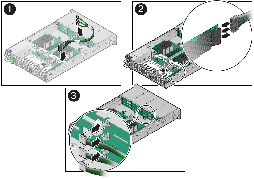

  1. Install the SAS cables between the disk backplane and the rear PCIe slots [1].
    Route the SAS cable bundle through the cable trough along the left side of the chassis.
    image:Figure showing SAS cables being installed into the                             server.
  2. Reconnect the SAS cables to the Oracle Storage 12Gb SAS PCIe RAID HBA, Internal card in PCIe slot 11 [2].
    Plug each cable into its SAS connector until you hear an audible click. To ensure proper SAS cable connections, see the SAS cable connections table in Step 3. See also Install the Internal HBA Card and HBA Super Capacitor.
    Note -  SAS cable assembly, part number 7117387 is required to connect the HBA card to the disk backplane.
    Note -  If your server is configured with Oracle Storage 12 Gb SAS PCIe HBA, Internal (non-RAID) cards, reconnect the SAS cables to the Oracle Storage 12 Gb SAS PCIe HBA, Internal cards located in PCIe slots 10 and 11.
  3. Reconnect the SAS cables to the disk backplane [3].
    When attaching SAS cables, ensure that you match the numbers on the SAS cables with the SAS connectors on the disk backplane and on the HBA card. Use the following table to ensure proper SAS connections between the disk backplane and HBA cards.
