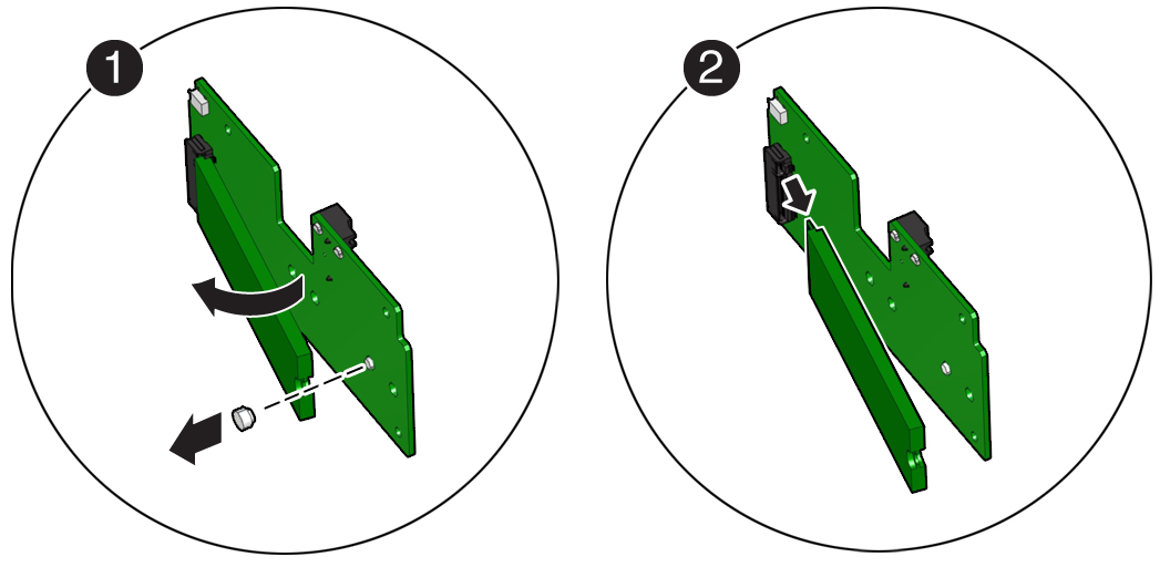

  4. Remove the M.2 flash SSD in socket SSD0 from the riser board.
    1. Using your fingers, push the plastic retainer clip through the flash riser board to release the M.2 flash SSD from the riser board [1].
      image:Figure showing an M.2 flash SSD being removed from a riser                                     board.
    2. Remove the plastic retainer clip from the M.2 flash SSD [1].
    3. Lift up on the end of the M.2 flash SSD where the plastic retainer clip was removed by one-half to one inch [2].
    4. Gently slide the M.2 flash SSD card back and out of the connector to disengage the SSD contacts from the riser board socket [2].
