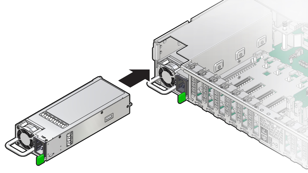

  1. Remove the replacement power supply from its packaging, and place it on an antistatic mat.
  2. Align the replacement power supply with the empty power supply slot.
  3. Slide the power supply into the slot until it is fully seated.
    You will hear an audible click when the power supply fully seats.
    image:Figure showing a power supply being installed into the                             chassis.
  4. Reconnect the power cord to the power supply.
  5. Verify that the amber Fault-Service Required LED on the replaced power supply and the Fault-Service Required LEDs are not lit on the front and back panels.
