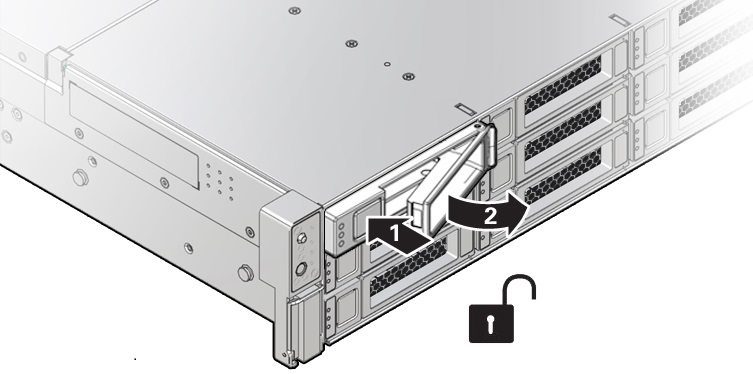

  3. Remove the storage drive.
  4. Push the latch release button to open the drive latch [1, 2].
    image:Figure showing the location of the storage drive release button                                 and latch.
    Callout
    Description
    1
    Pressing the latch release button.
    2
    Opening the latch.
    Caution
    Caution  -  The latch is not an ejector. Do not open the latch too far to the right. Doing so can damage the latch.

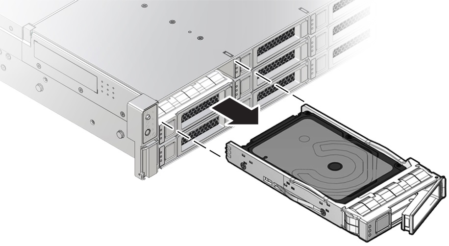

  5. Grasp the latch and pull the drive out of the drive slot.
    image:Figure showing a storage drive being removed from the                                 server.
  6. Consider your next steps:
    • If you are replacing the drive, continue to Install a Storage Drive.
    • If you are not replacing the drive, install a filler panel in the empty drive slot to maintain proper airflow and perform administrative tasks to configure the server to operate without the drive.
      For information on how to install a storage drive filler panel, see Remove and Install Filler Panels.
