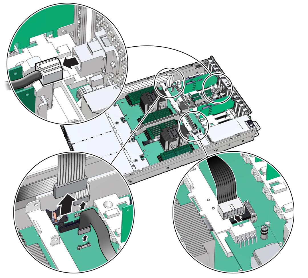

  4. Disconnect the following cables from the motherboard:
    image:Figure showing cables being disconnected from the motherboard                             assembly.

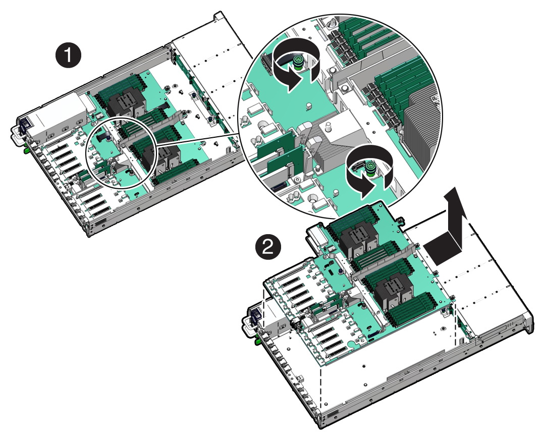

  5. Using a Torx T25 screwdriver, loosen the two captive screws that secure the motherboard mid-wall to the chassis [1].
    image:Figure showing the motherboard assembly being removed from the                             server.
  6. With the server in the extended maintenance position, remove the motherboard from the server with all reusable components that populate the motherboard in place [2].
    1. Carefully slide the motherboard forward, and while holding the motherboard mid-wall, lift it out of the chassis.
    2. Place the motherboard assembly on an antistatic mat, and next to the replacement motherboard.

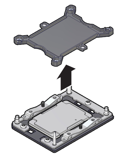

  9. Remove the processor socket covers from the replacement motherboard and install the processors.
    1. Grasp the processor socket cover finger grips (labeled REMOVE) and lift the socket cover up and off the processor socket.
      image:Figure showing how to remove the processor socket                                     cover.
    2. Install a processor into the socket from which you removed the processor socket cover.
      See Install a Processor.
    3. Repeat Step 9.a and Step 9.b to remove the second processor socket cover from the replacement motherboard and install the second processor.

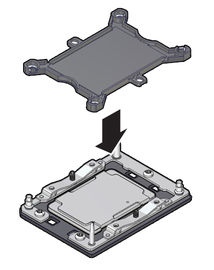

  10. Install the processor socket covers on the faulty motherboard.
    Caution
    Caution  -  The processor socket covers must be installed on the faulty motherboard; otherwise, damage might result to the processor sockets during handling and shipping.
    1. Align the processor socket cover over the processor socket alignment posts. Install the processor socket cover by firmly pressing down on all four corners (labeled INSTALL) on the socket cover.
      You will hear an audible click when the processor socket cover is securely attached to the processor socket.
      image:Figure showing how to install the processor socket                                     cover.
    2. Repeat Step 10.a to install the second processor socket cover on the faulty motherboard.

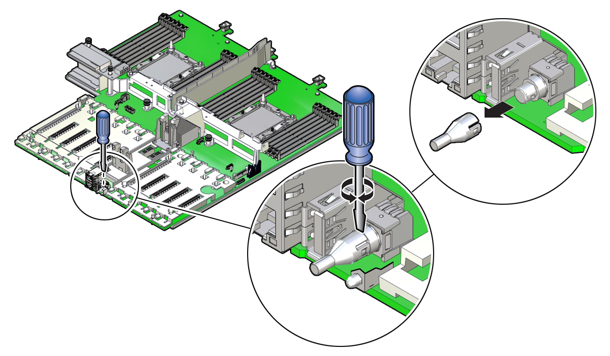

  11. Check to see if the replacement motherboard has a locate light pipe installed.
    • If it does, no action is necessary.
    • If it does not, perform the following steps.
    1. Check to see if the replacement motherboard came with a light pipe. It should be in a separate plastic bag.
      • If you find a replacement light pipe, skip to Step 11.b.
      • If you do not find a replacement light pipe, perform the following steps to remove the light pipe from the faulty motherboard.
      1. Insert a flat tool such as a screwdriver or penknife blade between the light pipe housing and the light pipe.
        Caution  -  Equipment damage. The light pipe is fragile. Handle it carefully.
        image:Picture of location of light pipe, and the motion                                             to remove it.
      2. Twist the tool back and forth to release the light pipe from the housing.
      3. Pull the light pipe away from the housing.
    2. Install the light pipe on the replacement motherboard.
      1. Match the rectangular holes on the outside of the light pipe with the retaining clips on the housing.
        image:Picture of light pipe being mounted on the                                             housing.
      2. Push the light pipe onto the housing until the clips latch in the holes.
