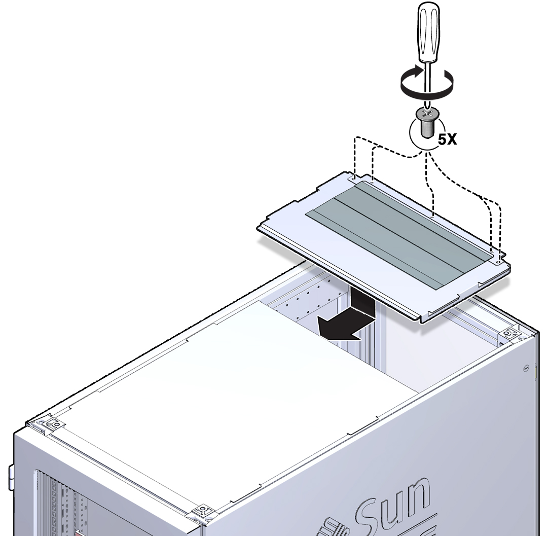

Carefully replace the
top panel on the rack.
For the two-piece top panel, place the larger section on top
of the rack before inserting the edge of the smaller section under
the lip of the larger section.
- Place the top panel support brace
on the rear of the top panel.
Line up the support brace screw holes with the holes in the
rack frame.
- Using a No. 2 Phillips screwdriver,
tighten five No. 2 screws to secure the support brace and the top
panel to the rack frame.
- Open the doors and connect the grounding strap to the top panel.
For the two-piece top panel, connect grounding straps to each
panel.
- If necessary, power on the rack.
See Power Off the Rack.
